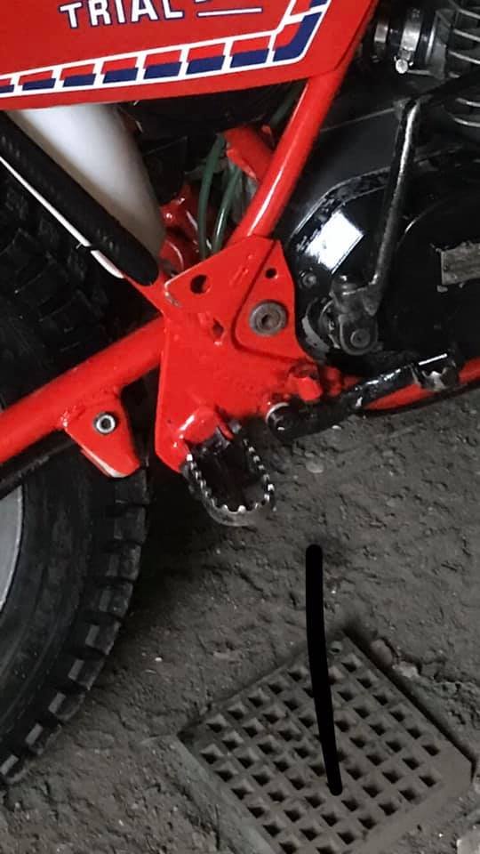

It looks like it would be easy to make and weld a wedge as shown and weld on the peg holder. I could gain an inch of drop but nothing back.

Good idea, welding on top of the frame instead of a butt joint. That’s a simple way to get a custom location. Thanks for posting!
Edit: I just looked and removing the peg mount and adding an overlay like b40rt shows the new peg mount can move down and back without having to move the kickstand. Thanks for sharing your ideas.
