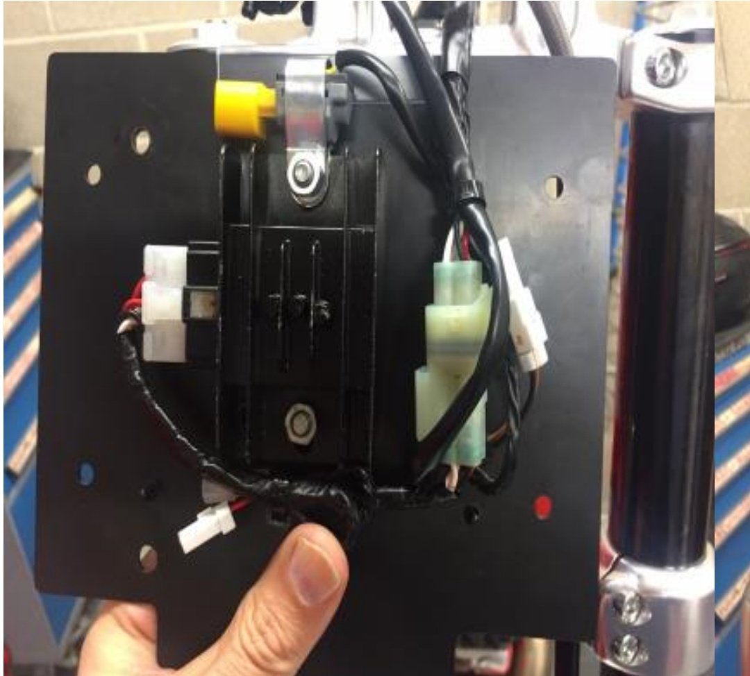

On 6/5/2020 at 8:05 AM, worldtrialchamp said:
The fan controller is located within the headlight... How you could have resolved this without the controller is beyond me
You can remove the headlight and then remove the box off the headlight and mount it to a front number board with bolts. This is the way Beta UK tell you to do it for the SSDT. Unplug the lights but don't remove the wiring.  Dead easy. The connector to the headlight is the one at the bottom. Map switch at the top. Kill switch on the far right. Main harness connector on the left and right. This is the rear view. When fitted all this faces the headstock.

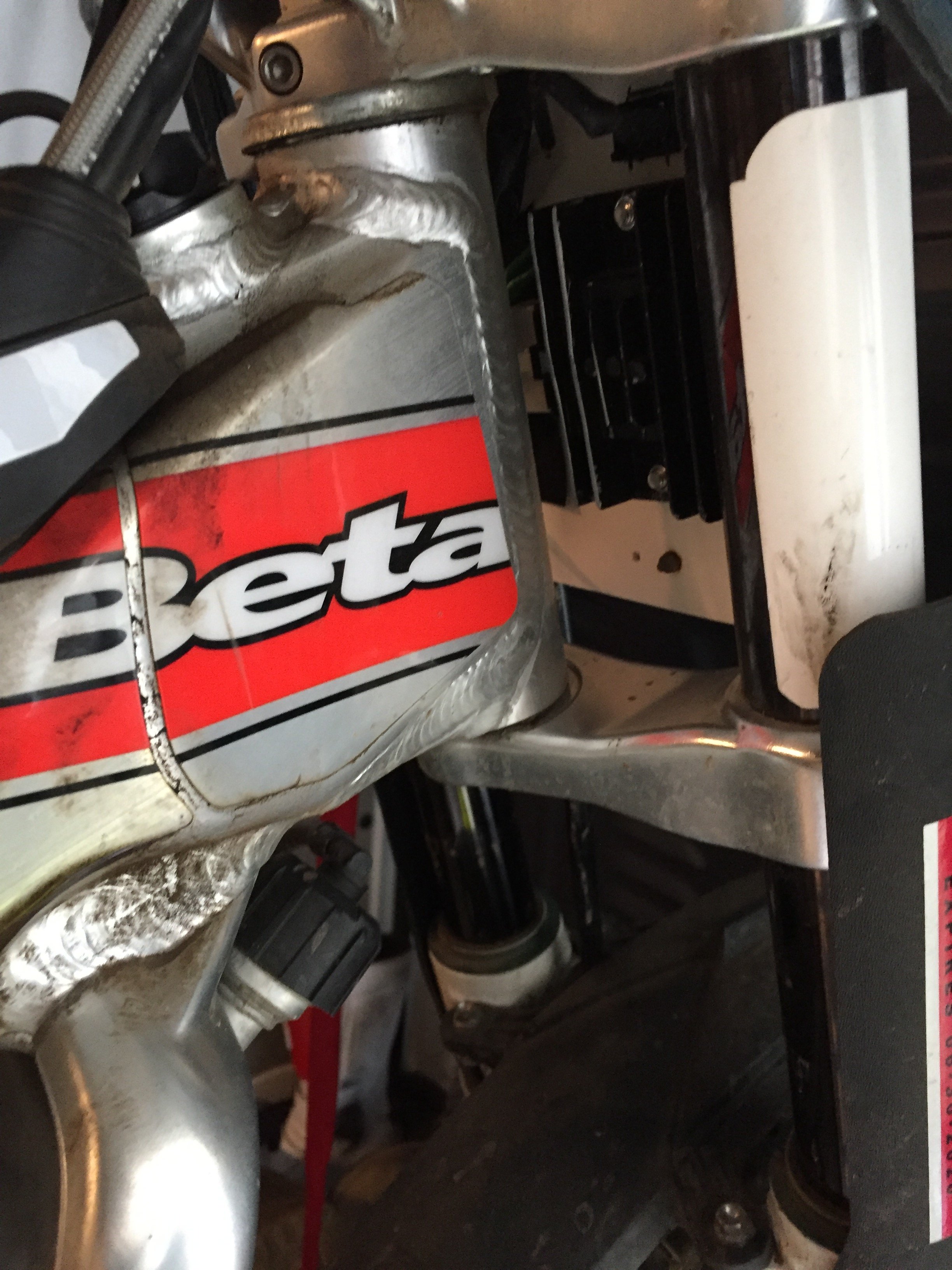

2 hours ago, worldtrialchamp said:
So you're claiming remove the headlight won't affect fan operation.. I've seen a number of EVOs boil from this....
No I’m saying the fan “controller” is in the radiator but you need the regulator to run the fan. Semantics. 309F0284-FD03-466F-8535-899479D872D5.thumb.jpeg.f8d0b7461dcc223395e6d1d58d4aa840.jpeg
