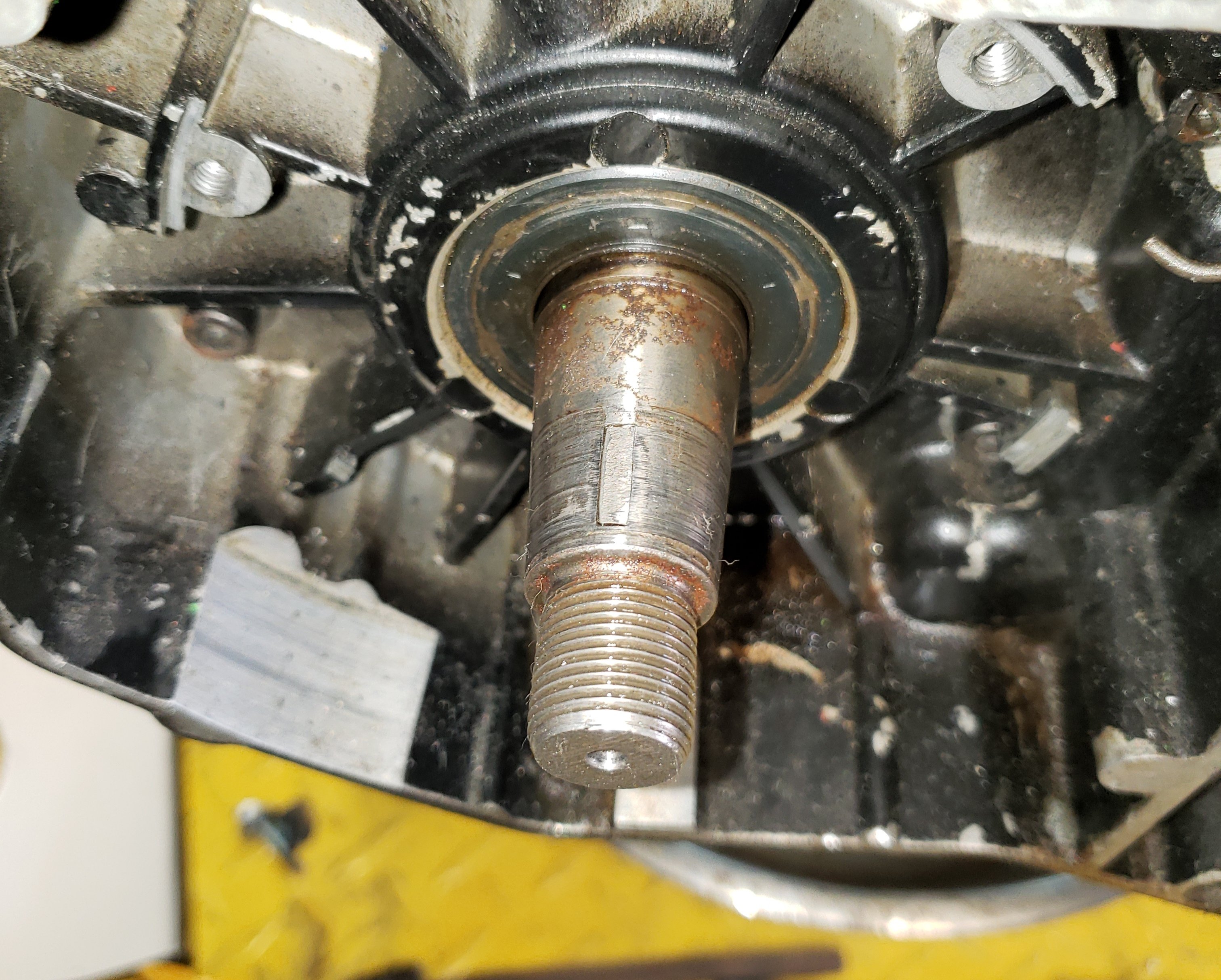

Turns out the key was sheared off. Guess I gotta fix that first

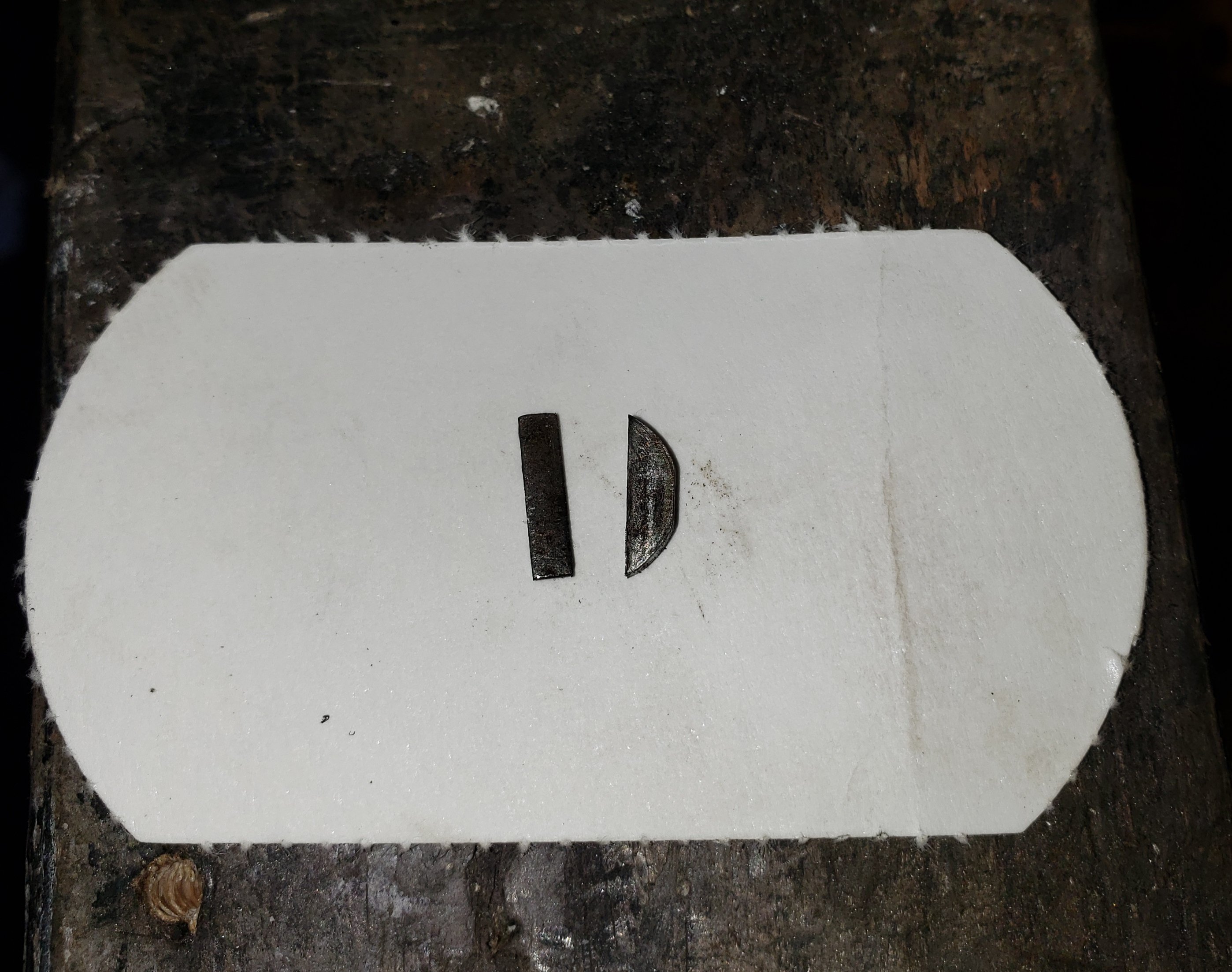

Looks like a standard half-moon Woodruff Key.   Unless it's been metricated, it could be a standard 1/8 inch width.   I have known some people that could make their own, out of mild steel bar.   Try to clean up the gaulled shaft taper, and flywheel...    At least you now know why it was backfiring..
Found a new woodruff key. Got it timed as close to spec as I could.  Got a new condensor and relocated under the tank.

woodruffe is purely for location.
I would lap your flywheel to match the taper, to ensure it doesnt shear again, to be safe.
