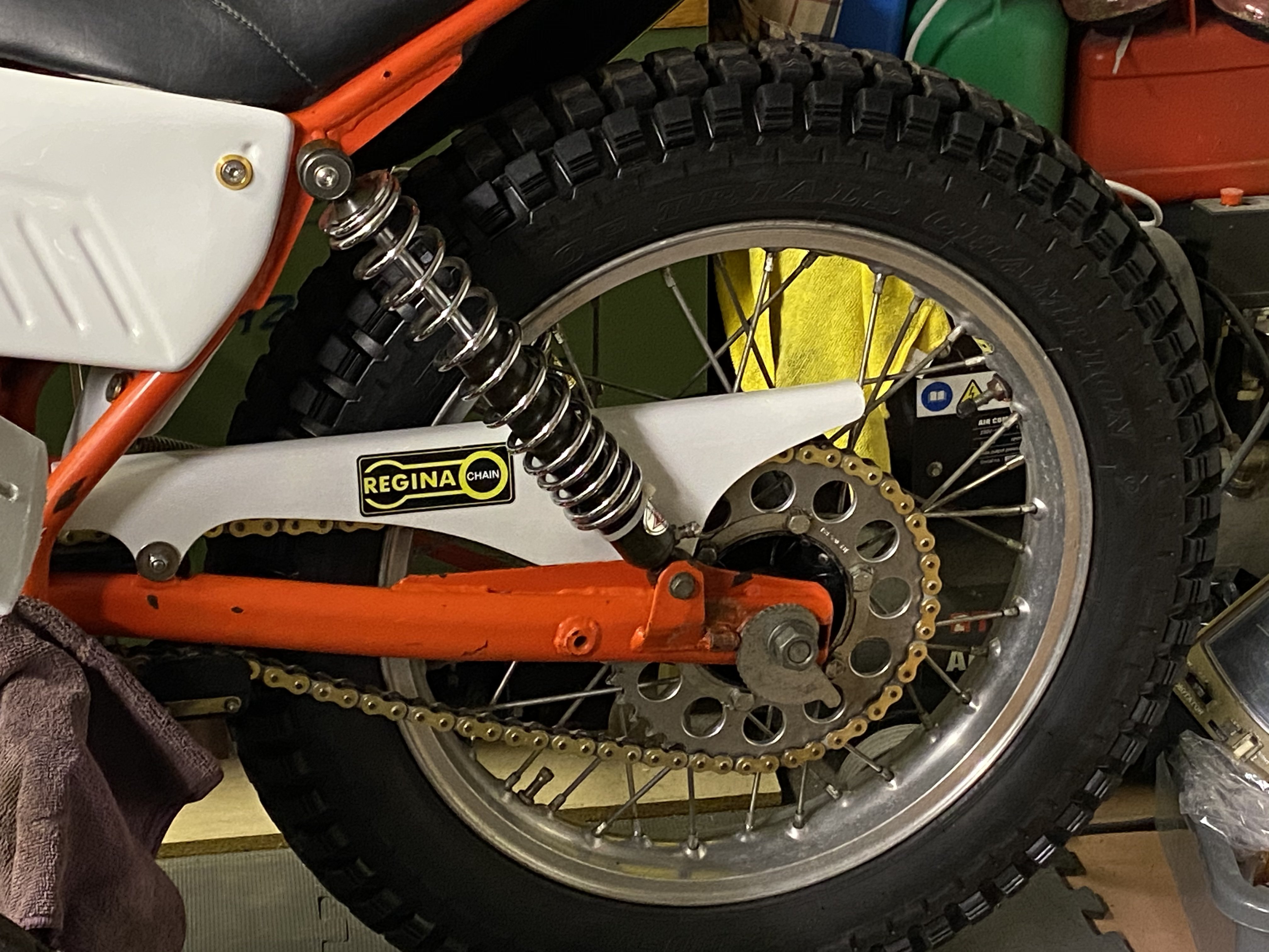

Afternoon,
I have recently fitted a pair of NOS Betor rear shocks. After moving the circlips up a couple of rings they still feel spongy....

I have found the issue.....??‍♂️ eBay purchase and wrong c2c listed.... I should have checked before.... should be 340mm these are 330mm
my fault ... never mind
new purchase required
thanks ?

I've seen an additional "end" welded on, not the prettiest solution but if you can weld takes 10 mins.
I suppose I could ask my chum with a lathe and milling machine to cut me some longer tops with the eyes 10/15 mm further from the top cap and fit them with bushes....?
Turn your shocks up the other way, to reduce unsprung weight and to avoid knocking the air valve off.  You will also find that this improves the feel of them.
The shocks are actually too short by about 10mm
Also, I have turned them around but they are still not correct as too short
thanks for the advice
regards and stay safe and well
When you order the new shocks remember to get the heavier 50lb  springs for angled shocks, I have a set of the adjustable betors on my TY250C with majesty spec shock position & they work really well
