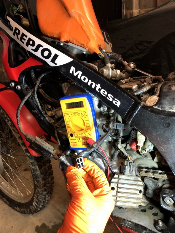

Well, I temporarily installed (without fan fitted) and filled the rad with water so the temp sensor sensing, unpackaged the voltage regulator bundle, ran the bike, removed the fan relay, bypassed it and measured voltage at the fan supply to find it reading 6.6v.
 What does that mean?
The fan motor is toasted - more or less siezed. When connect it to the running bike (with relay bypassed) the bike idle dips under the load and wires get hot (I pulled the bypass wire out and it burnt my little pinkies :( )

I’m measuring 6 volts at the fan motor supply with engine at idle. (I expected it to be high but it’s low voltage).
Presumably a regulator problem ?
