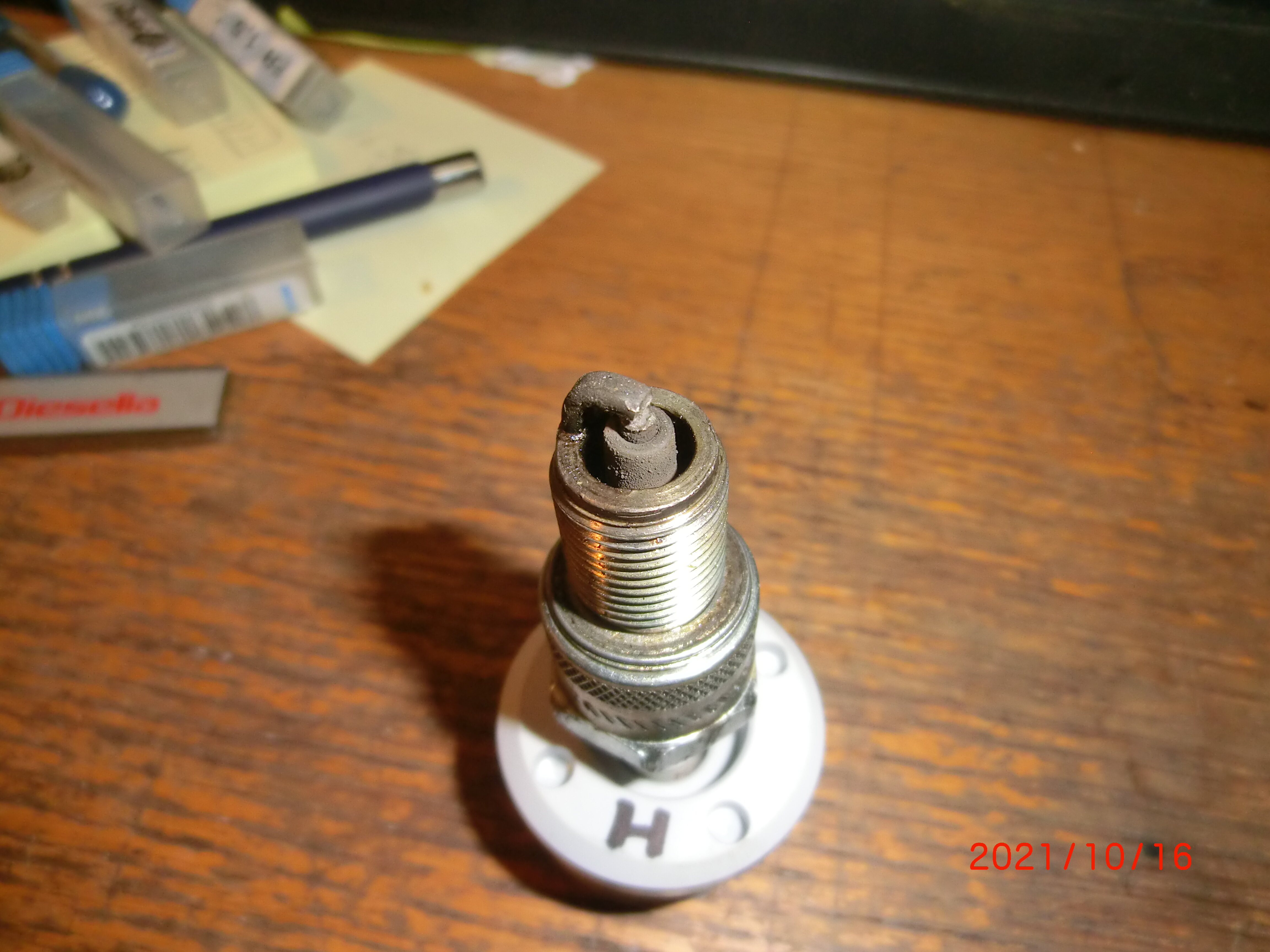

October 16, 20215 yr If plug is too hot it may cause pre ignition and pinking if very much too hot the plug may melt down. If too cold carbon will build up at electrodes and perhaps start to misfire. If very much too cold sparking will stop and engine stops. Combustion process and cylinder head temperature does not change until something bad happens. Lean mixture and retarded ignition may increase engine temperature. If very bad engine may melt down. Always start with manual specifications and importer instructions. If they say a hotter plug is needed. Use that plug This is after 4 years in my 199A. I crashed (dropped it at the floor) the plug some weeks ago when I for some reason had to take it out. Plug is Champion N11YC. Difficult to get a good photo
