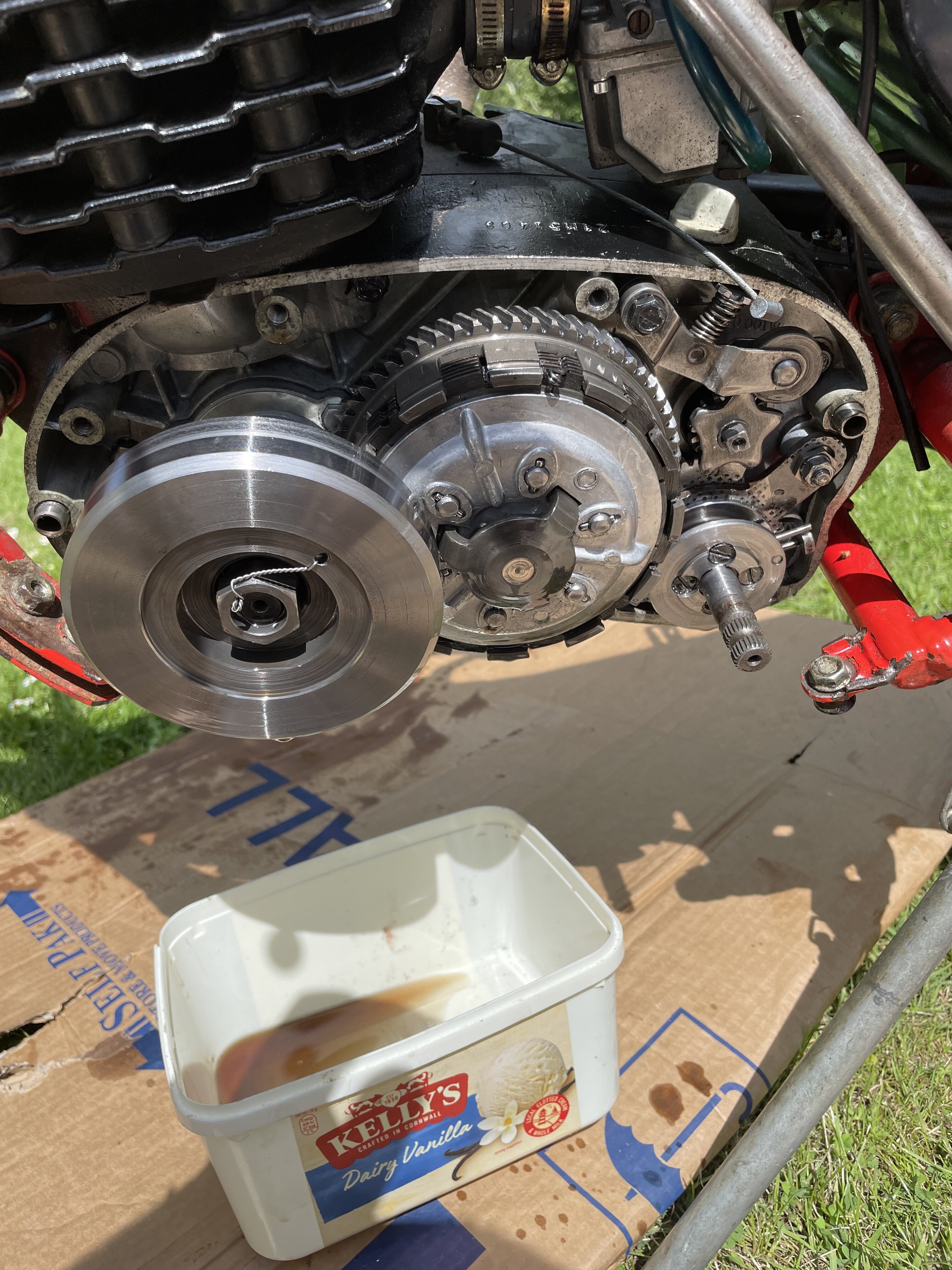

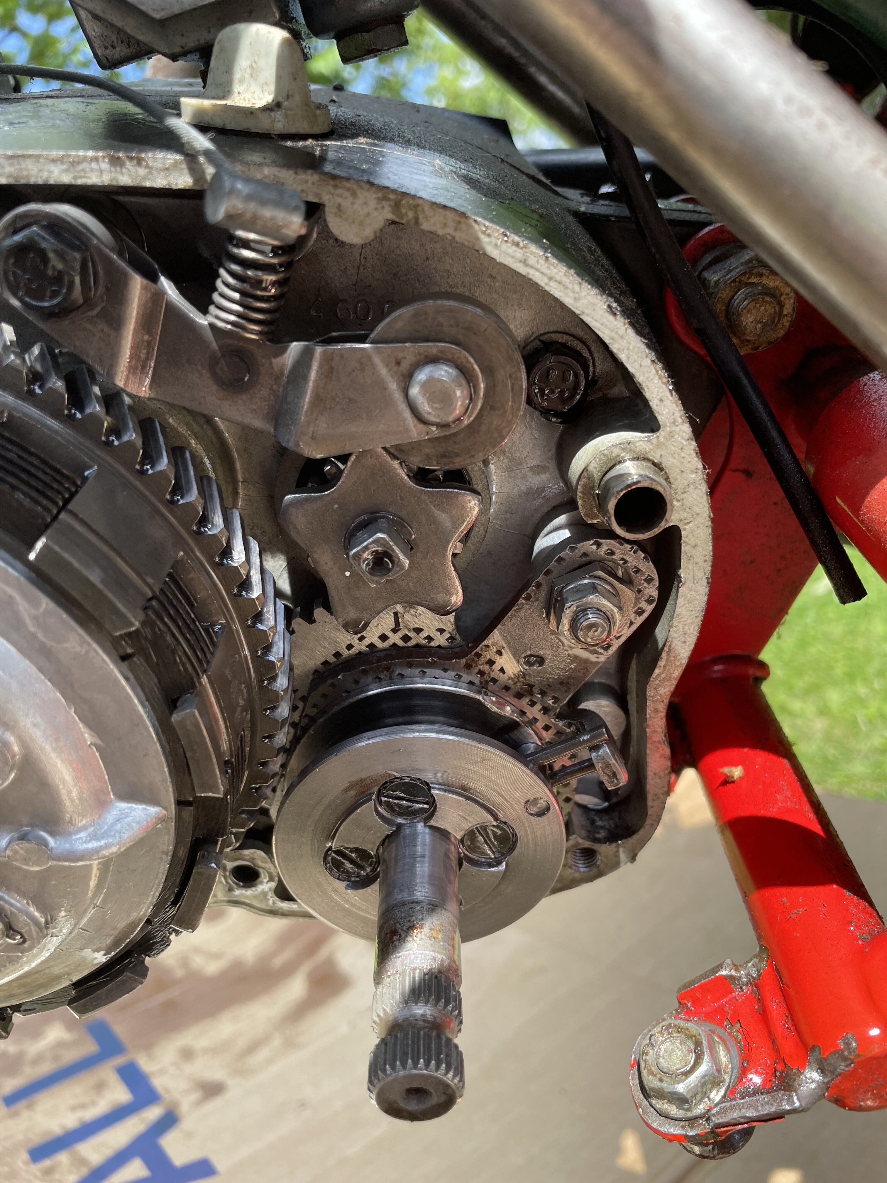

I’ve whipped it off. As far as I can see it looks okay. I might have to take the whole engine out and dive deeper into the gearbox 5332718C-7CB3-48DD-8735-2B346A7FC59B.thumb.jpeg.91408b2761523ce1a4266d17eebdf4a7.jpeg37CA18A3-7E3E-486B-B208-867A8ECD69F9.thumb.jpeg.b3e0d8cca909d6ecbb636d8bb5a002f6.jpeg

All looks in place to me, I'd check selector mechanism first by loosing the three screws and the bolt on the right hand side.
You can check the gears are ok by turning over the engine and putting a spanner on the square shaft in the middle of  the star wheel.
Link to comment
Your gear change problem is the dimpled plate held in place by the M6 nut. Its an eccentric adjuster. Has to be i the right pace to get all the gears.

Thanks for the list. Luckily the last owner replace the tyres, chain and rear sprocket before I got it. I took the 3 screws out of the gear selector and took it off. The ‘pawns’!? The slanted blocks of metal with a spring popped out and I looked at the plate you said about. I checked the exploded diagram I have and it doesn’t state where it should sit.

Is the spring broken?  The spring is locked in place by the pin towards the rear
It isn’t broken but it is very loose and as I understand it should hard to get on and off? At the moment it falls off easily. I’ll order a new one
Link to comment
It isn't hard to get on or off.  But it controls the rebound of the gear lever ie: when you push down for first the lever moves back up to the middle position etc.  I can't see how you can do a 180degree turn if the spring is operating correctly.  I have a 247 and the selector is different but the spring has the same function.
