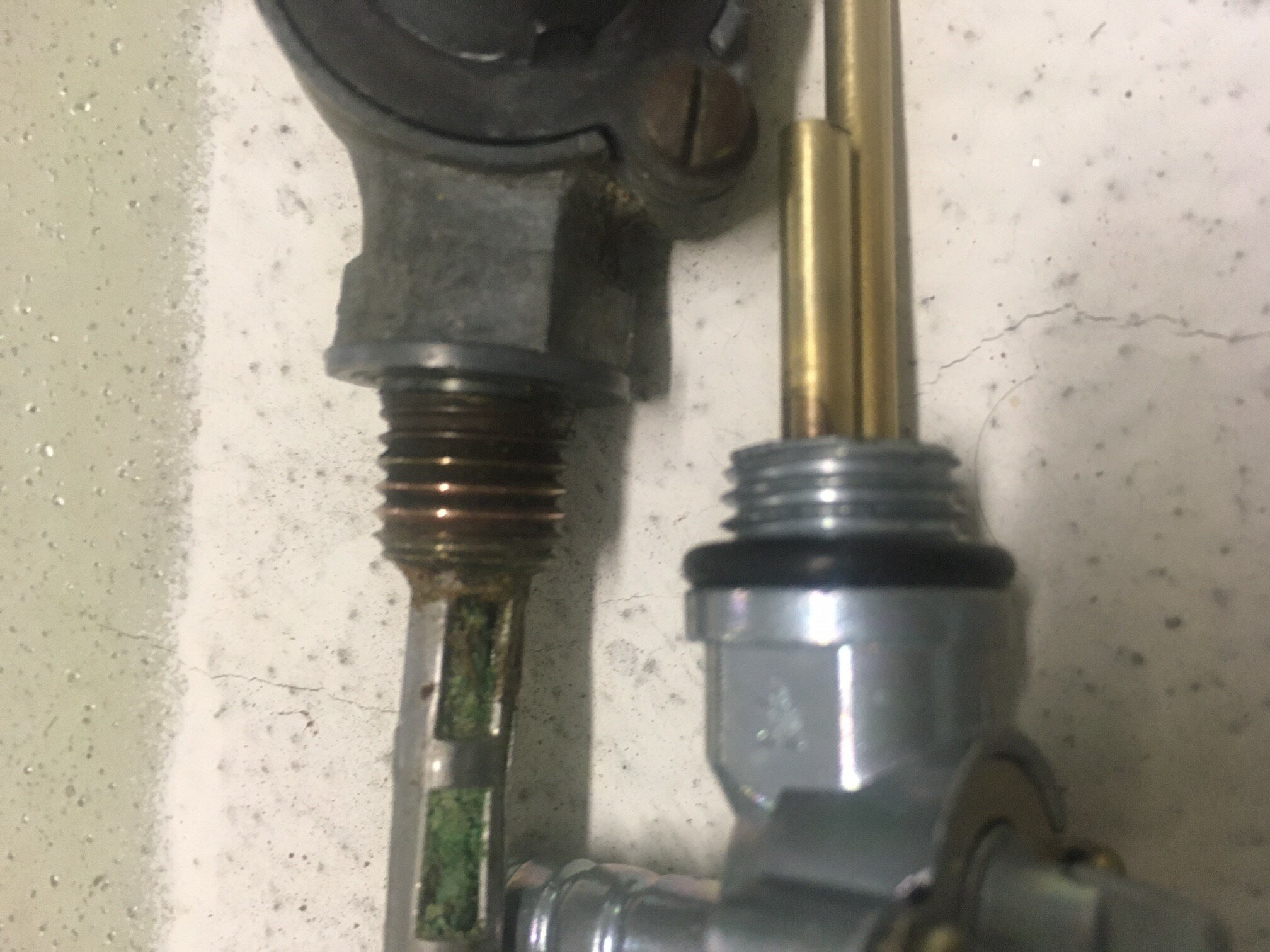

progressing slowly, thought many times: "thats it..." but won't run properly. So I got a new petcock after having a look in the net what thread should be used... came up with M12x1,5. After some modifications on the petcock I wanted to try... but as you know... it just allways takes some extra time, which is just not available that much. The petcock doesn't fit, Can it be a M10x1,5? I have attached a pic to have a look... probably someone knows anyway,
Joachim
Why not clean the existing tap ?  Beneath all that green-coloured rubbish in the slotted part of the tap (shown in the lower part of your pic.) you should find a fine mesh screen. Wash it out/ blow it out with an airline, if available. Try using a carb. cleaner aerosol, maybe.
well tried that... ultrasonic cleaning... still not clean, so I thought it just might be better to change it and keep the old one to really take care of it and change it back after restoration and after the bike runs reliable...
