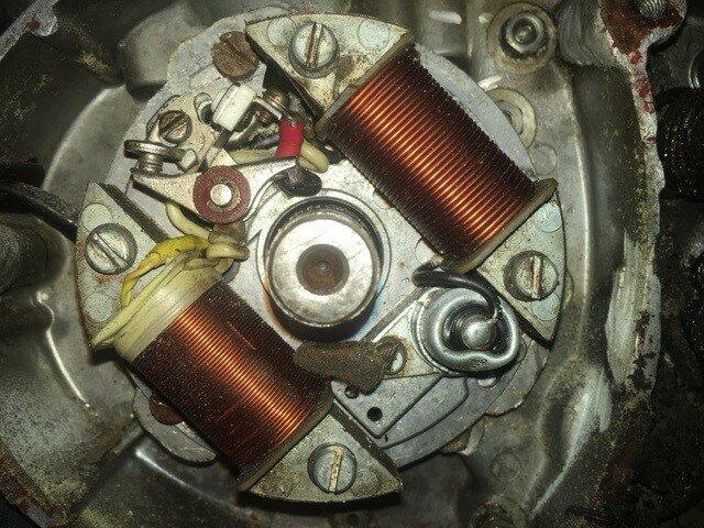

So... managed to take the flywheel off... discovered an essential part missing... like this no points will be opening, but see for yourself!!!
What next?
Edited by jofritz
so I think, this is how it is suposed to be... but I can't see no cam!!!
is it mounted on the backside of the flywheel?
the M33x1,5 , I had to use a wrench to screw it on and used some selfmade construction to hold the flywheel in position... actually it had a hard time finding its way into the flywheel thread... just did not feel good to force the old bike...
The condensor/capacitor in the picture is damaged, if you didn't do the damage, this is probably your problem.
well, I did 🔨 while trying to block the flywheel...
Ordered an automotive 12V as recommended earlier, will replace and locate outside the hot spot...
