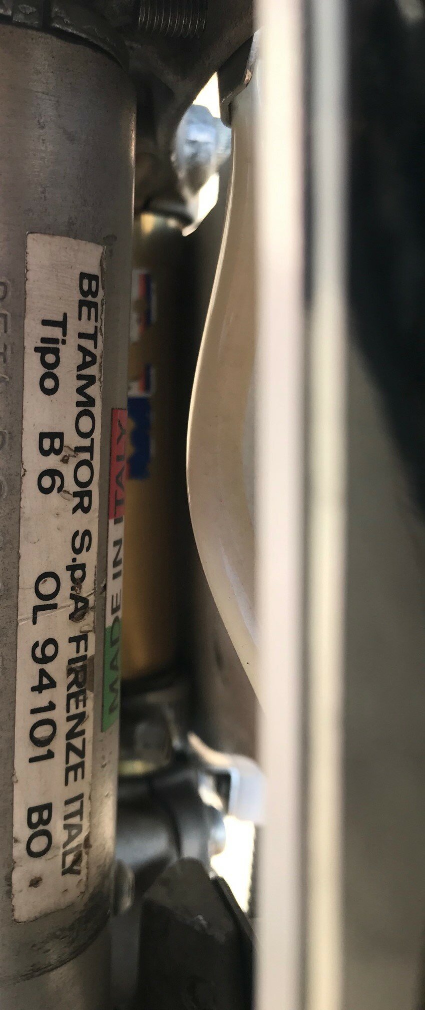

I am new owner of a 1993 Beta Trials bike and trying to figure out some things on it.  Previous owner didn't know much about it and never even added gas - he was just flipping the bike.  I'm not even sure what model bike it is - it shows Tipo B6 and OL9401 on the tag, no headlight, white rear fender, orange front fender and around a 250cc according to the seller.  I found the 1991 manual online that one shows a 2% fuel mixture - which I assume to mean 50:1?   But, most of these forums say to run 70 or 80:1, with a higher octane fuel (around 100 octane if I can get it).  Most of those threads are referring to newer bikes.  If I'm using Lucas Semi-synthetic 2 stroke oil (since I have it) what are your recommendations on the mix?

‘93 Beta Gara. White rear with grey front. Orange fender is probably off a ‘96. 80:1 is fine with synthetic oil. Gearbox oil is not super critical as people run everything from gearbox oil to ATF to 10W30 motor oil without a problem. Clutch might be sticky when cold. Fix is noted above. Mikuni may piddle fuel. Fix is noted above.

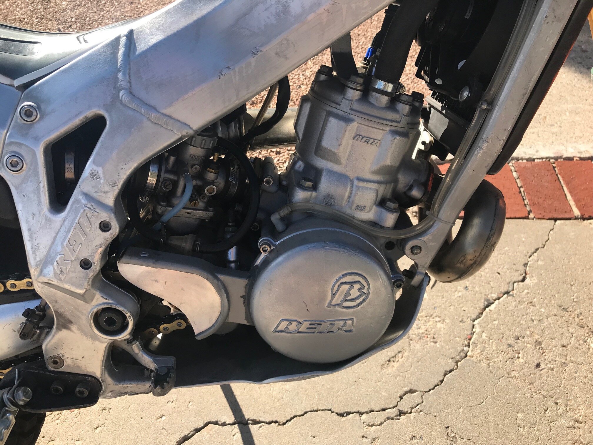

I looked at some more Beta sites and now wondering if it might be a 1996 Techno 250?  Thoughts?  I am attaching a pic.  Websites showed the fork being inverted on the 93, and this one is right side up.
