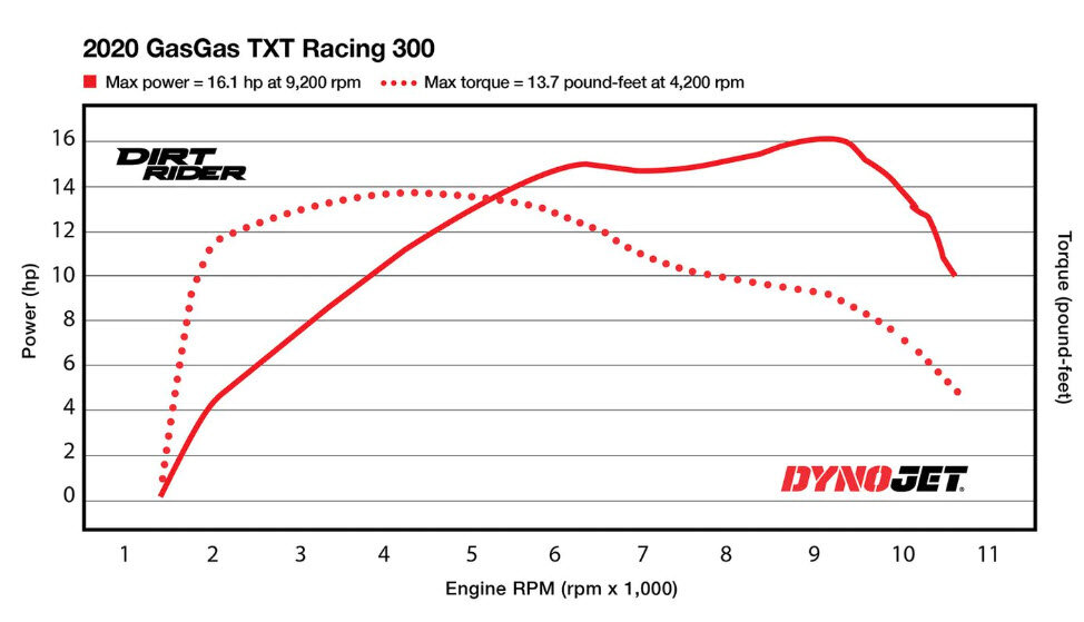

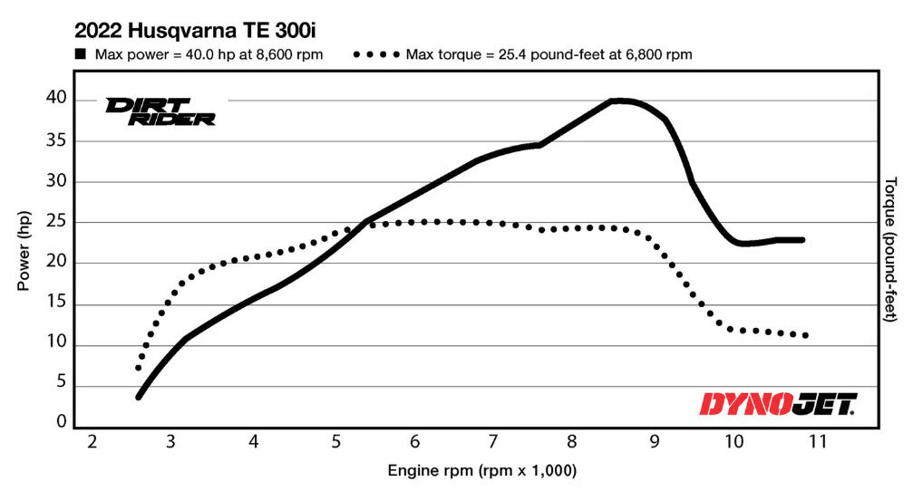

I would have guessed a 300 made well over 20 but it's not even close. The graphs show how differently trials-specific engines are tuned compared to their MX and Enduro cousins. And given these numbers, it seems crazy how 300's are often considered to be too much for the average rider.
Edited by PAULIE
Wow lookat the torque curve ln the gas gas, near vertical  from about 1500 to less than 2000 rpm. I've  found the gas gas 300 pretty rideable  actually, the 300 beta however i find tiring  to ride, be interesting  to see the figures  for it.
