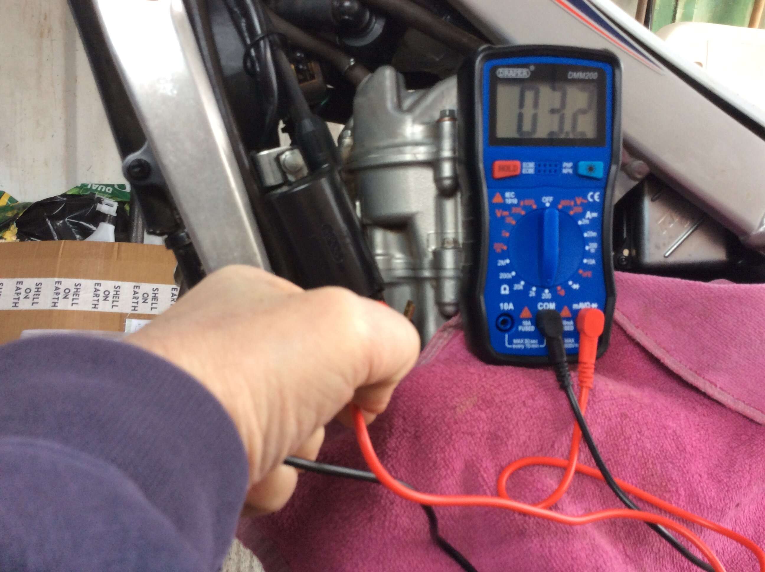

Check resistance on the coil & its 3.2

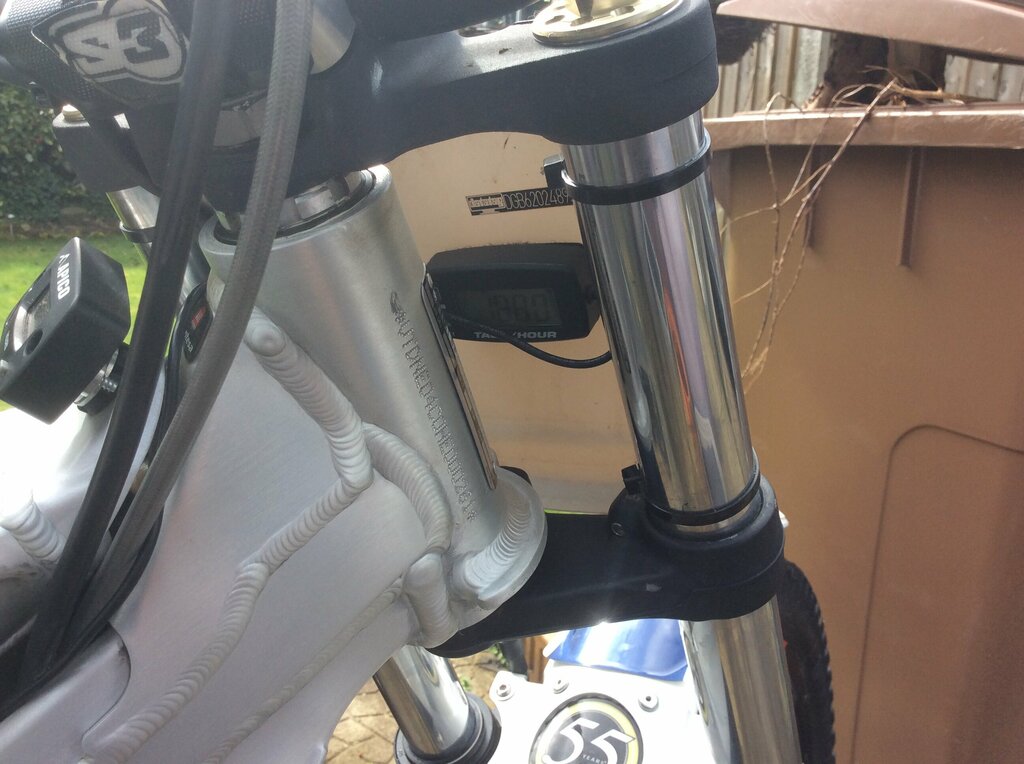

still cant get the tachometer to work, can’t get the RPM to read the1 P: 1r or 1P : 2r or 2P:2r as per instructions
i am reading the MMright aren’t i?

im just using the tach as & when I need it as I already have one bolted to the bike which I can’t get to go to 1P:2r
anyone have any ideas? Holding the button in to change from hours to rpm works but holding the button in until it gets to 1P:2r doesnt
