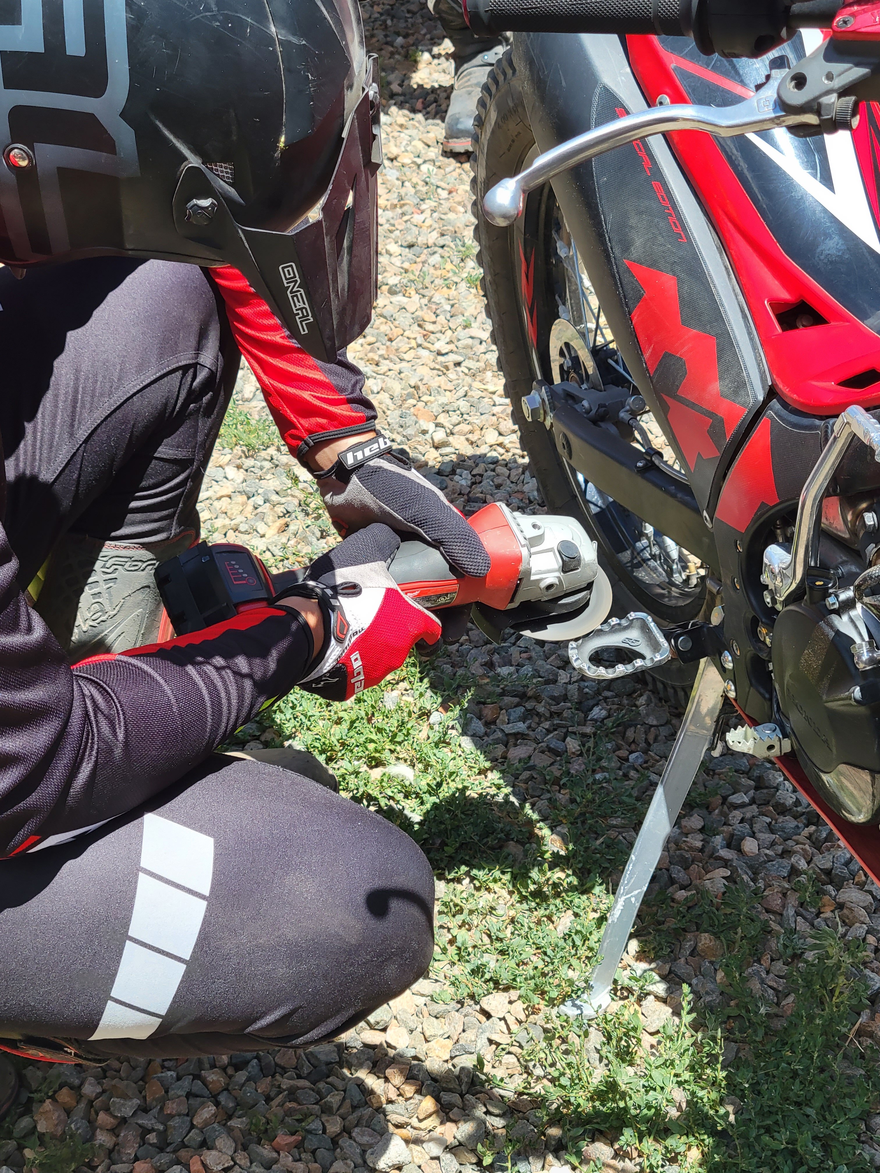

Usually I start with the easiest things when finding a solution to a new occurance on any non starting machinery. Not jumping into something  towards the end of possibilities.
 As i typed this my sons kick starter stuck to his foot peg. I handed him a grinder and fixed in 30 seconds.20230704_123710.thumb.jpg.945c23902df87e170d3bcc5a325dd6a5.jpg
fwiw 4RT came with 2 different length kickstart levers over the years, the one pictured above is the longer one that comes on a 300RR
I found the long actually don't jam up as badly or wear out your right boot like the shorter one does.  Little easier to kick.
Trouble with the short one, it's like a knife blade. Had one make a friend an extra drain. Halfway between his anus and scrotum. New Year, first trials first section. What bad luck!
