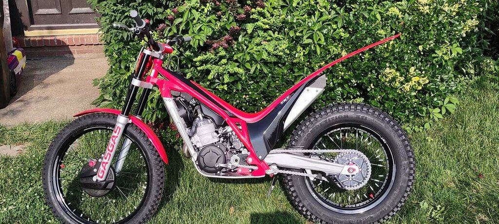

The magnet is a very dumb device. It can fly off with a hard hit, a small branch, bush, or just waving at your friends wife.
 I tossed mine right away and run a real teather and a kill switch. The NATC has changed the rule from being a wrist strap device. I prefer it attached at the waist. No accidental fives and I am hands free.
 My bikes on the left and I changed the strap out to a short red one. I cand buy the lanyards online 2 for 10 dollars.

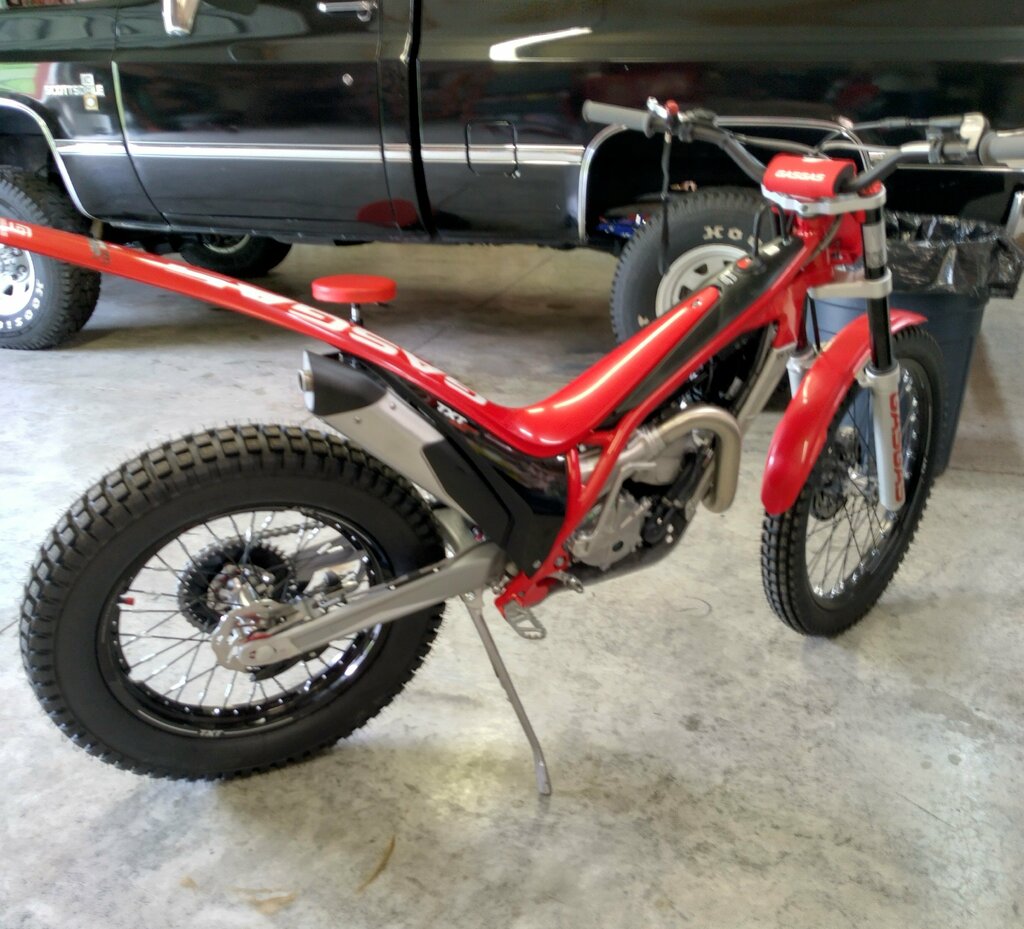

Nice bikes there lineaway. I'm still recovering from cancer surgery but getting stronger everyday and can't wait to get out on this baby!IMG_20230731_143727_HDR.thumb.jpg.865a43ac3e363f91c0d3ef940cb94360.jpg

Weve just had the wettest july in recorded history. Your grass looks like it could do with some rain😁

Butch, like the square body in the background!
Thanks! That's my 83 back there. She's been with me a long time. 350 4 speed granny low. So much fun to drive. Mechanically she's very much completely restored. Body and paint is so so. She needs a little work on the bed sides and new paint

FWIW, I find they are more fun to drive when the body isn't immaculate...
