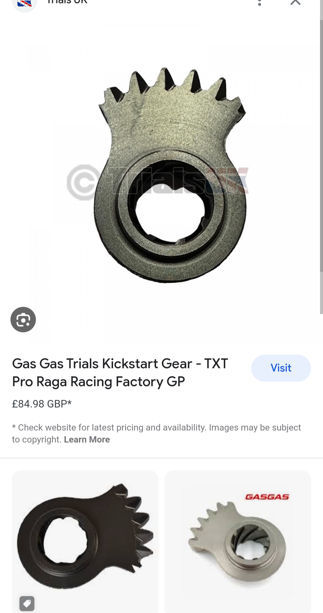

 You do not have to roll it back. What are you going to do when you are stuck in an awkward spot. Which happens all the time in trials. You just slowly kick it through till you can get the kicker just before top dead center. That is the lever is up as high as it can be to get a better through kick. You also have to get the lever to engage first. The kick starter gear is called the bart gear as it is only a half moon verses a full 360 degree gear as most bikes have. Like Bart Simpsons hair cut. That is one of the weak spots on the gasser as the gear chips off quite easily. The other weak point is the shift drum. That is why the shift lever is designed to bend easily.

Yeah all you new guys have no clue about the reputation of this motor. And I can`t believe KTM is still selling it. The transmission broke so much they changed the cases so you could fix it without splitting the cases. I made alot of money working on these motors. On the flip side, the motor is awesome when working! LOL I think the last Full transmission I replaced was on a bike that was almost 7 months old. So out of warranty.
Thanks guys I'm going to try everything people are telling me. Lineaway are you serious about not having to split cases to do that repair? I've read a lot about that bart gear breaking for people. Something is supposed to be different for 2023 but I don't know what they did? Are you really serious about doing those kinds of repairs without splitting  cases? Man, I split cases on other bikes not fun! Especially like the time it was an xr honda and the cluster fell out before I ever got a chance to do anything. I had to go to Honda and get an exploded view printout. Not fun. I'm going to try the pull it back in gear method. Lineaway I'm just a little weak right now from the cancer and weight loss and all that crap but this isn't going to take away from me things I love. I'm working out a lot to regain strength. I enjoy chatting with friends on here. It's just great to hear everyones advice. I can't speak anymore so the keyboard and all you guys and a very understanding wife and daughter are all I have left now.all I have now. It makes me happy to communicate with you guys and I learn so much. Like the bart gear lol. Okay! I heard of that but I didn't believe that's really what it's called lol
Butch is definitely going to nail this yet! I never experienced anything like this with any other bike lol. But I'm going to get it. Then you guys can throw a big party for me lol. Lineaway can hide in the cake👍
 Yeah, they made the right center case so you could slide the transmission out without splitting the cases. Since KTM has most of the parts made in China now, we really have not seen many problems or many real trials riders buying Gassers. Gas Gas used to be the best selling trials bike in the USA. Beta is still the best selling world wide. Since I am old and slow ( I did win my class Saturday, but quit Sunday after a clean loop. C Bob was right, I needed a cold beer!) I ride the Montesa 301, but a very trick one.
