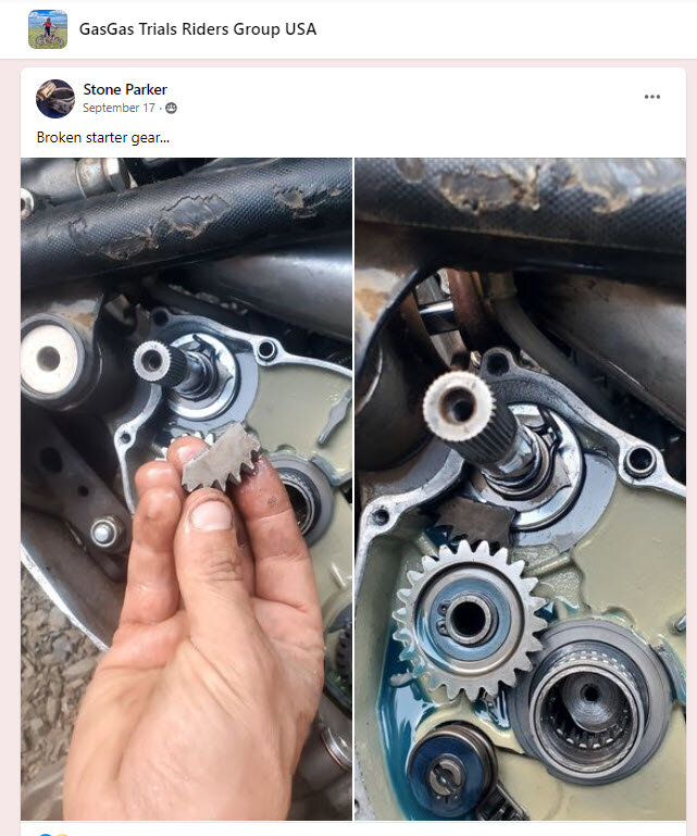

@manwithgunWhen Adam Raga was a GasGas factory rider he just used to flick the lever out on a 300  pro and kick it into life violently without engaging the quadrant gear carefully first,  but of course he was not paying the not insignificant sum of money for a new bart gear and idler gear after chipping all the teeth on them both.

A few photos of the broken Bart Simpson gear we discussed earlier from the GasGas Riders FB page.
Scottro,
What year bike was that taken from?  Do you know what specifically caused the breakage?
I think it was a 2020.  Improper/difficult kicking of the sort we've been discussing is the presumed culprit.  It's a post from a GasGas FB page.
Some folks have said KTM fixed the problem but I do not know what they did.  I use the roll back technique to start my bike.  Starts pretty easy cold or hot.
