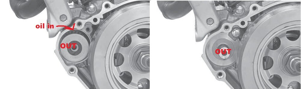

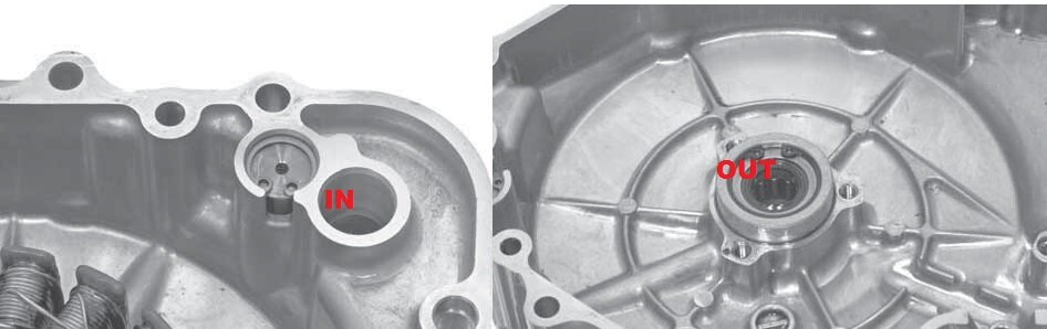

  • It does sound a little worrying as the filter is not receiving oil and then not delivering oil to the big end. As far as I know there isn’t a way to test the oil pump. To get to it is an engine out an

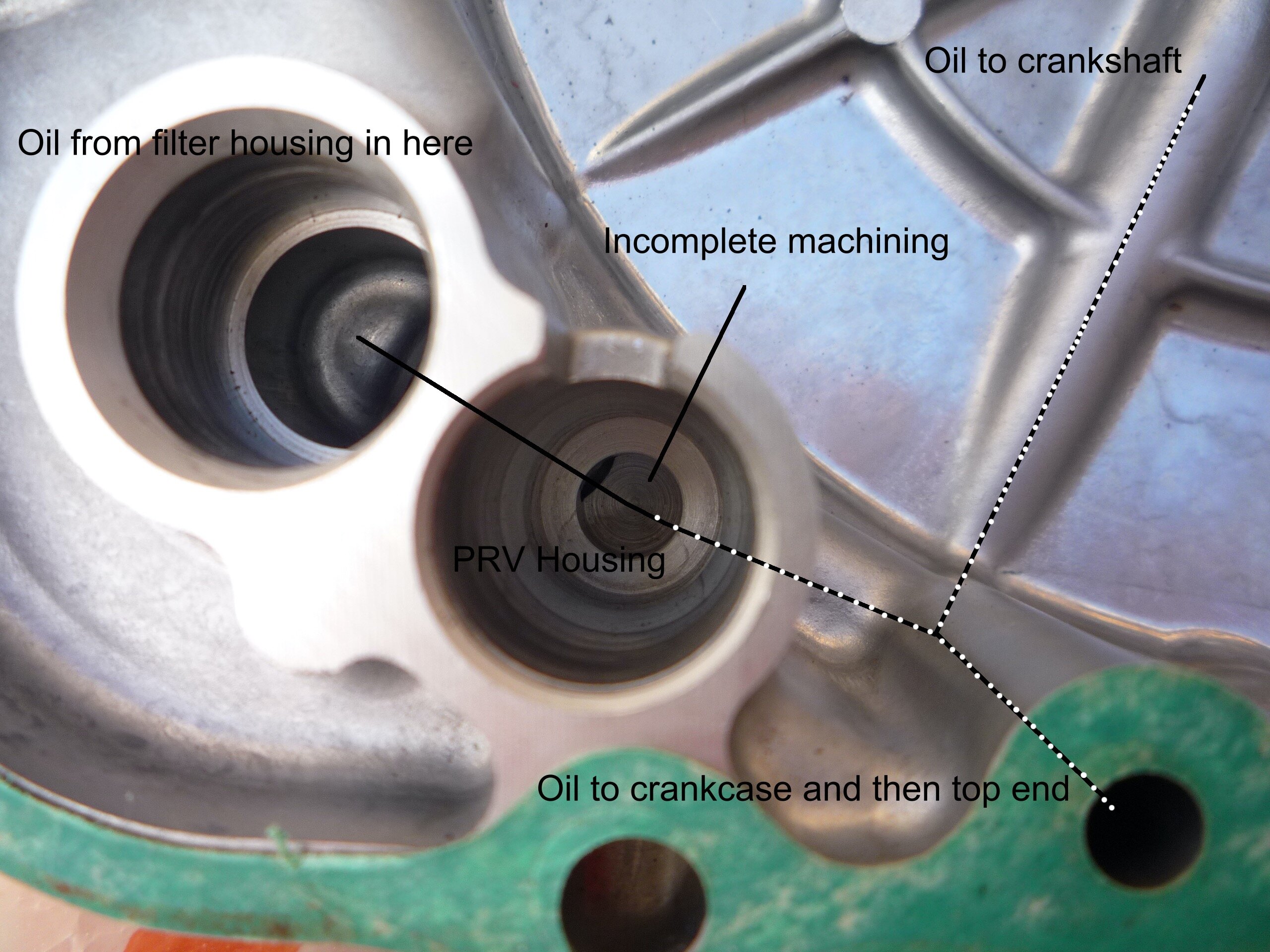

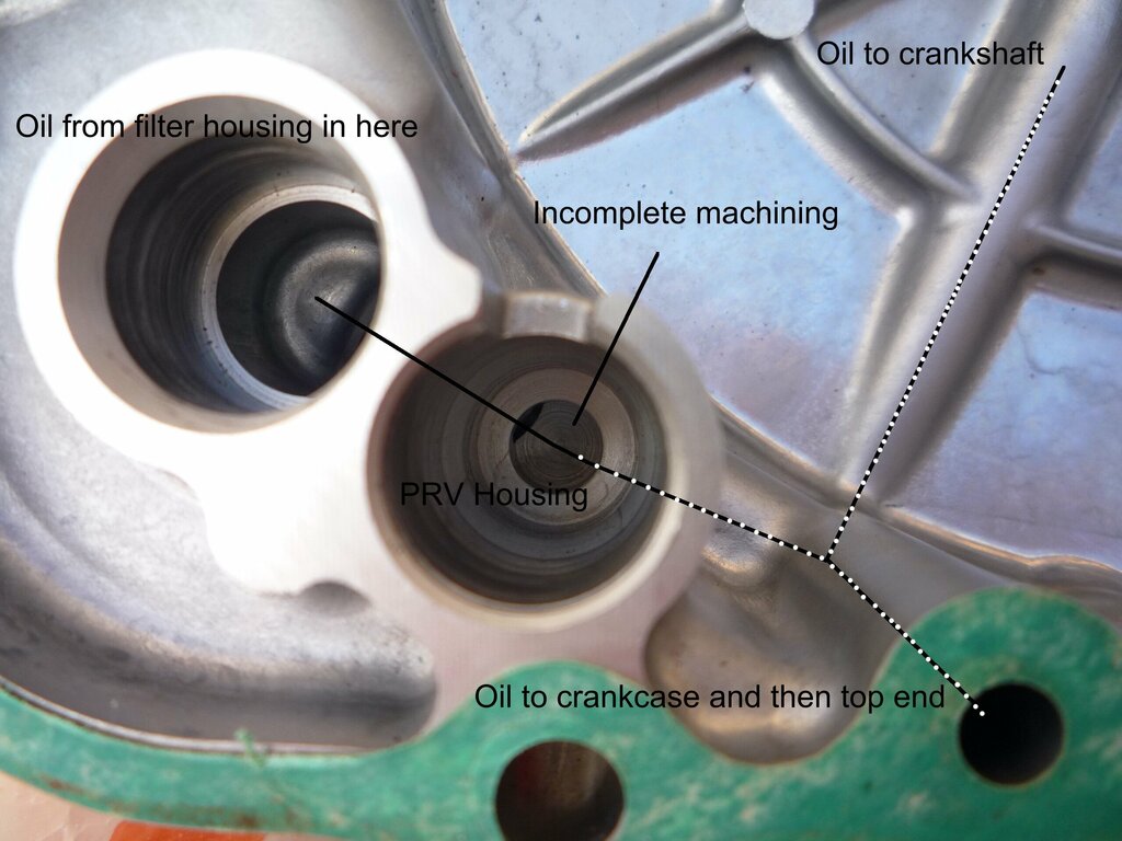

I have got to the bottom of the problem! There is a manufacturing defect in the cover where an oil way has not been fully drilled through between the PRV (seen with circlip in previous photos) and the oil ways which go to the crankshaft and back into the crankcase. The latter is the untapped middle hole that can be seen in the top right photo and, judging from its location at the front end of the barrel, probably provides the oil supply to the top end.
Effectively, the oil filter exit has been blanked off and not allowing any oil through. I cannot see the lubrication system being a 'bypass' one if oil is to be fed, at pressure, to the crankshaft and top end. Therefore, there has been no direct oil feed to the crank and top end from the first turn of the motor! Yuuurk!  The main bearings are shells so will suffer badly from a lack of any oil supply.
Not sure why the engine has not protested yet?  Any ideas?

A picture paints a thousand words!  I have annotated this one for those who are maybe not familiar with the engine.
As this is a significant and unarguable defect that has totally compromised the lubrication system, I am looking to a new engine.

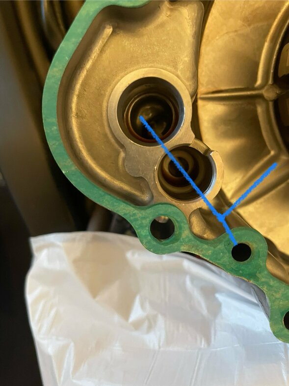

I have a 2023 260 owned from new with approx 30 hours on the engine. Received a letter today advising to STOP riding the bike and await further instructions due to this exact issue. The letter seems to suggest that a replacement casing only will be offered. Should Honda be replacing the entire engine?
Hi Mont339.  That's very interesting! Are you UK based or US?
In reply to your question I suppose it depends on what Honda identify as the problem they are addressing?  If it is for the same problem that I had, then you should be looking at a new engine but will probably have to fight for it.
If your engine has done 30 hours I am assuming it will have had at least one service where the problem should have been identified. Did you do it yourself or have a dealer do it? The crux of the issue is whether there is a total blockage that stops oil from exiting the filter housing and consequently starving those components further down the lubrication system that depend on it.  Mine was total but other defective cases might not be as catastrophically compromised from defective machining.
Let me know and I will offer what advice I can.
