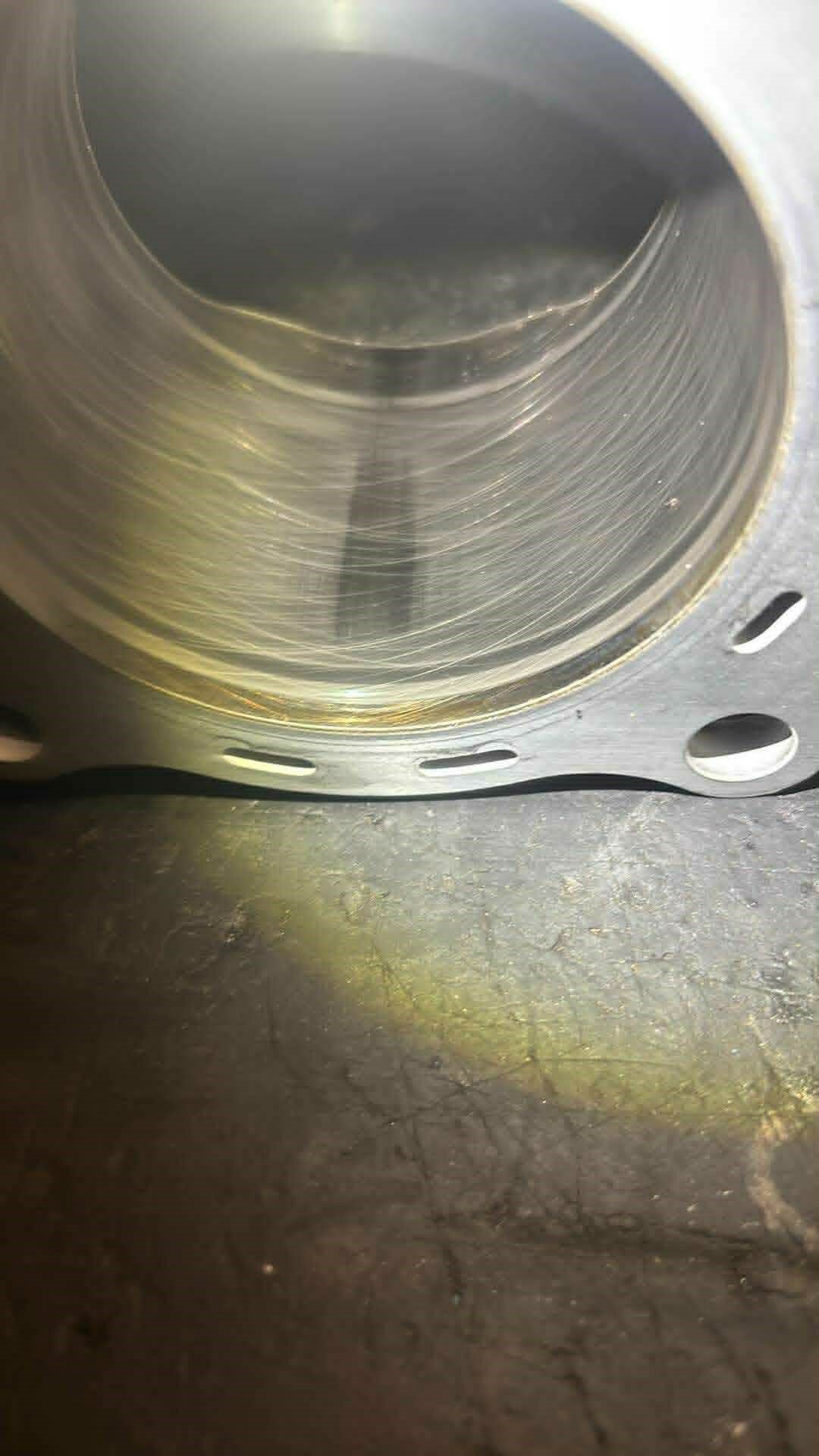

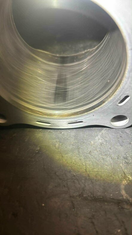

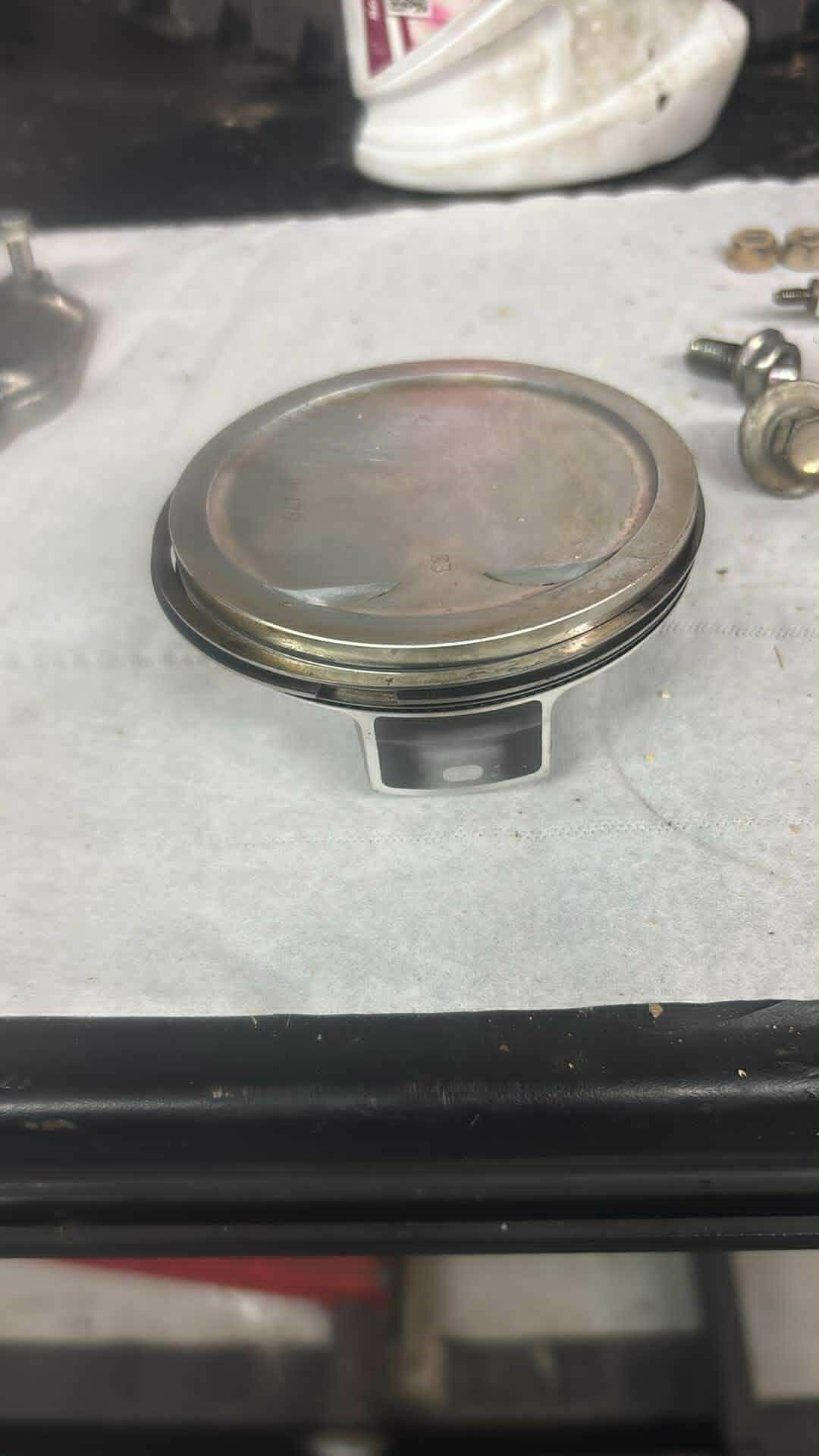

bobb Posted December 17, 2025 Author Report Share Posted December 17, 2025 Hey, I finally opened the 301 engine and my friend the mechanic was right piston was worn quite badly. No big damage to te cylinder wall just needs a light hone and an new piston and rings. Will fit a new distribution kit too now the engine is in bits. Bike has been well serviced and i use good full sysntethic oil. Maybe previous owner didnt serviced it enough? Quote Link to comment Share on other sites More sharing options...
bobb Posted December 18, 2025 Author Report Share Posted December 18, 2025 some pictures of the damage Quote Link to comment Share on other sites More sharing options...
lemur Posted December 19, 2025 Report Share Posted December 19, 2025 You sure you want to hone a plated barrel 🤔 don't think you are suppose to do that. Quote Link to comment Share on other sites More sharing options...
bobb Posted December 20, 2025 Author Report Share Posted December 20, 2025 that might be correct! parts are at the mechanic i tought it was a steel liner inside the cylinder but i only have seen the pictures Quote Link to comment Share on other sites More sharing options...
