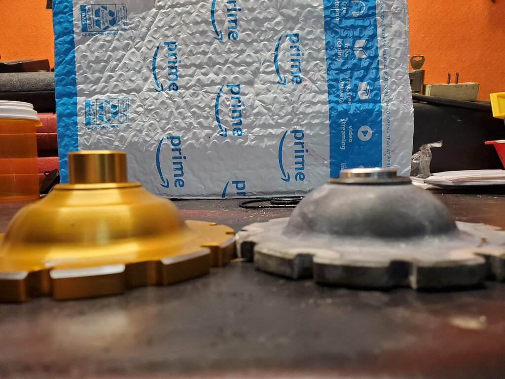

femi Posted February 22, 2024 Author Report Share Posted February 22, 2024 Funny story.. When I received the parcel from the shop I noticed that it's located very close to my work. So I went there to return and told them I'm the guy with the spark plug connectors. But they didn't notice so probably that's their daily business 😅. Anyway I put some into the tip jar and now everybody is happy. Meanwhile S3 parts decided to cut an insert down to short thread and send it right to me in a few days. A bit late but it's a good service. 1 Quote Link to comment Share on other sites More sharing options...

Assgas Posted March 8, 2024 Report Share Posted March 8, 2024 (edited) Wrong insert I bought one and had the same issue I was told the one you have is for a TRS gold 300 there not the same Edited March 8, 2024 by Assgas Quote Link to comment Share on other sites More sharing options...
femi Posted March 9, 2024 Author Report Share Posted March 9, 2024 S3 does not offer a certain insert for the gold. I don't believe that the gold has a different gas tank or cylinder than the RR so there shouldn't be any difference. Ask your dealer to get in touch with S3 they probably will send you an insert with short thread. Or get one of the spark plug connector that I posted. It will take some time until S3 react. Quote Link to comment Share on other sites More sharing options...
Assgas Posted March 15, 2024 Report Share Posted March 15, 2024 S3 part # 07030MT100 is the correct low compression insert Quote Link to comment Share on other sites More sharing options...
femi Posted March 16, 2024 Author Report Share Posted March 16, 2024 Seems to be an obsolete part number since it's not listed on the S3 website anymore. Quote Link to comment Share on other sites More sharing options...
Assgas Posted June 1, 2024 Report Share Posted June 1, 2024 On 3/16/2024 at 4:37 AM, femi said: Seems to be an obsolete part number since it's not listed on the S3 website anymore. That is because S3 messed up making them Quote Link to comment Share on other sites More sharing options...
Assgas Posted January 30, 2025 Report Share Posted January 30, 2025 Send it back you have the wrong insert .They gave that to me also .A long sparkplug will not fit you need this one. Quote Link to comment Share on other sites More sharing options...
arnoux Posted February 4, 2025 Report Share Posted February 4, 2025 On 3/16/2024 at 3:07 AM, Assgas said: S3 part # 07030MT100 is the correct low compression insert That is not an S3 part number, it is a TRS part number for the low compression insert used in the ONE R. 1 Quote Link to comment Share on other sites More sharing options...
