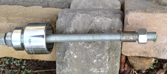

lemur Posted May 14, 2025 Report Share Posted May 14, 2025 (edited) If the chain tensioner is doing something when the bike is at rest with no rider aboard you are good to go, if the rubber block is touching the swingarm at rest that's not good. ... so far this year alone I spotted 3 bikes with the axle set crooked and I noticed it because the chain tensioner was doing nothing when they parked their bikes. Make sure the axle is good and tight and that your wheel bearings are perfect, wheel bearings wear out fast. Edited May 14, 2025 by lemur Quote Link to comment Share on other sites More sharing options...

lemur Posted May 16, 2025 Report Share Posted May 16, 2025 (edited) 2 hours ago, RonH said: Lemur, what brand of bearings do you use? SKF from a local being supply 6 or 8 at a time. You can buy different specs, expensive bearings have more balls and tighter specs. ... made up a puller to change them super easy, the steel sleeve to extract the bearing spacer is cut from a used CO2 canister. Edited May 16, 2025 by lemur 1 Quote Link to comment Share on other sites More sharing options...
RonH Posted May 16, 2025 Report Share Posted May 16, 2025 (edited) 17 minutes ago, lemur said: SKF from a local being supply 6 or 8 at a time. You can buy different specs, expensive bearings have more balls and tighter specs. ... made up a puller to change them super easy, the steel sleeve to extract the bearing spacer is cut from a used CO2 canister. Awesome! Thanks for the puller photo also! I’ve got everything to build one. Edited May 16, 2025 by RonH Quote Link to comment Share on other sites More sharing options...
lemur Posted May 16, 2025 Report Share Posted May 16, 2025 You are going to find bearings have a precision rating, low numbers are low quality, higher number ABEC rating cost more. Same tool is good for pressing in the new bearing, use an old bearing to push the new one in, works slick. 1 Quote Link to comment Share on other sites More sharing options...
