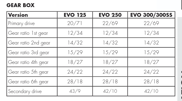

konrad Posted 21 hours ago Report Share Posted 21 hours ago This is a topic near and dear to me. I keep spreadsheets with gear ratios for a variety of bikes. Modern trials bikes will all have the same problem, a wide gap between the "section" ratios and the "loop" ratios. The most even spacing I've measured among trials bikes was my old TXT321. Never had that gearbox apart, but counted motor revs per wheel rev as: 39.25, 33.75, 26.50, 20.75, 13.25, 9.00. Typically, a 6-speed box will offer a slight improvement over your Sherco's 5-speed. FWIW, I've discovered that single-speed electric trials bikes work really well as a technical trail bike. 1 Quote Link to comment Share on other sites More sharing options...

JonM Posted 18 hours ago Author Report Share Posted 18 hours ago 3 hours ago, konrad said: This is a topic near and dear to me. I keep spreadsheets with gear ratios for a variety of bikes. Modern trials bikes will all have the same problem, a wide gap between the "section" ratios and the "loop" ratios. The most even spacing I've measured among trials bikes was my old TXT321. Never had that gearbox apart, but counted motor revs per wheel rev as: 39.25, 33.75, 26.50, 20.75, 13.25, 9.00. Typically, a 6-speed box will offer a slight improvement over your Sherco's 5-speed. FWIW, I've discovered that single-speed electric trials bikes work really well as a technical trail bike. Thanks, Konrad. ACU currently aren't keen on electric Enduro or MX bikes- and of course it's the range issue. I want to be able to do a lap (with a seat), come in, refuel, go again. Quote Link to comment Share on other sites More sharing options...
