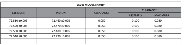

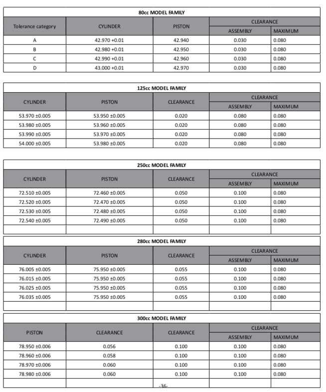

mcman56 Posted September 9, 2025 Report Share Posted September 9, 2025 I was curious so looked at the manual. It looks like the minimum piston clearance for the 250 is 0.050 and the maximum is 0.080. What is the 0.100 "Assembly" number? Quote Link to comment Share on other sites More sharing options...
konrad Posted September 9, 2025 Report Share Posted September 9, 2025 At first, I was going to say the "assembly" number is the service limit. But viewing that table in the context of the other displacements, it makes no sense at all. It's a horrible table! Quote Link to comment Share on other sites More sharing options...
