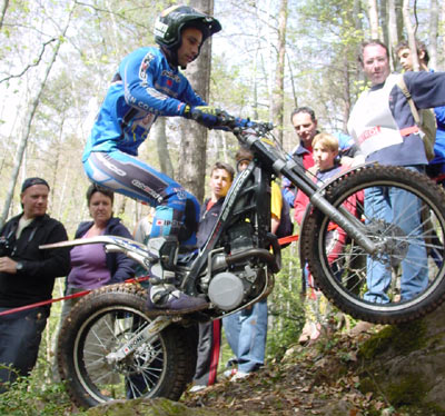

(with photocredit to todotrial)
http://www.todotrial.com/Fotos/trialesinte...3DTS-cabes1.jpg
