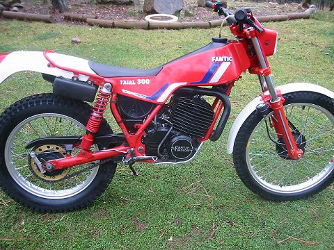

As she now is presentable to the world ! Has anyone tried the njb Trikshoxs yet ? and does any one out there know the jetting for a 26mm delorto for the 240 ? I have 2 here and would like to try one instead of
the 25mm that came on her. but both carbs are off tl320 swm's and I don't know what the jetting should be for my bike or what it is for a 300 ... And heres some pics of the old basket case !!!

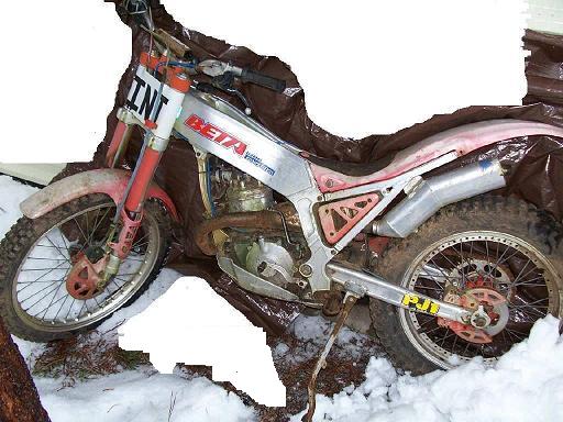

:thumbup: Thanks Heath ; and yes it's cramped in the hotbox with the 2 SWM's in there too ! I'll have to build a new shop before I start on restoring the really ugly 90 beta zero ! It's to much work to move all the bikes out just so I can get to my meager home toolbox. And excuse the mess !!!
And this is the next victom ! (yes that is mold on the engine!)

Hi Glenn,
I have looked at my 243 engined 240- It has a PHBH26 carb, which I think came from a 300 fantic. main Jet is 95, Pilot Jet is 45, It has a X5 needle and a BN264 Needle Jet (Needle runs in this!) The starter jet is a 70. Finally the float jet (rises and falls with the float to stop and start petrol flow) has 200 stamped on the side. The bike has a std. 240 exhaust and a wes silencer and the porting has been advanced by putiing two base gaskets, lowered exhaust and transfer ports and the head was skimmed by 0,6mm. I have a stainless flywheel weight added to calm things down. The bike pulls very well off the bottom and revs out fully in any section.
Hope this helps.

Thanks Lee , I think I'll get some gaskets and jets and start play with my carbs ! I hope I can keep her single kick starting hot or cold with a different carb set up ! Right now it runs great except that when you go wide open for more than a few seconds (steep long hills for example ! ) it stumbles just a bit , I can let off and back on and it will be OK for another little bit ... And yes I've played with the float level , new filter and petcock to assure full fuel supply ! I also found a K&N gauze air filter to fit comfortably in the stock air box and seal up quite well with some 1/4 inch closed pore self adhesive weather strip on its edges !! (k&n pn#E3211).With the needle clip in the stock location it made a serious difference in throttle response , really crisp for a old girl . I think a new Wes silencer and some carb experiments and it'll be even better. !!!

Hi Glenn, before ou go and change things drastically , like fitting a new carb, what size is your main jet....a 98 or 99 I imagine. Fit a 95 and clean out and repack the silencer. I think it will cure the problem!
lee
Lee, I have to get a Wes silencer before I can clean and repack it ! I've cleaned the original one to the best of my ability without cutting it open and welding it back up ! and both of my 25mm carbs have 98 mains I haven't had a chance to look at the other carbs yet .and I have to get some delorto gaskets before I take them apart again ! all the gaskets are O.E. on my fantics for sure... I'm going to try to make a ITSA event at the B&J ranch in sept. so I'll get bob to have a silencer waiting for me then , or beforehand.
