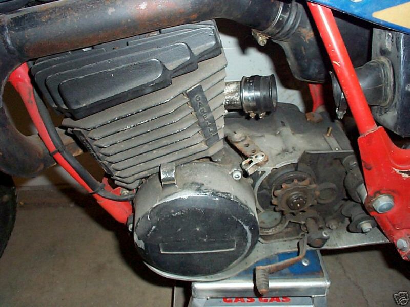

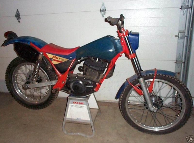

I just won the E Bay auction for a former Donato Miglio works Garelli Trial 320. I am very excited to get my hands on this rare and interesting bike. I wonder if there's anyone out there who knows anything about them or has one? I searched the web and found a guy in CZ who is looking for kickstarter parts. I am certain the kicker mechanism is a weakness of this machine. I will be trying to resolve this problem enough to at least ride the old girl a little bit. Heres a picture of the beast. Sincerely, Jay Lael.

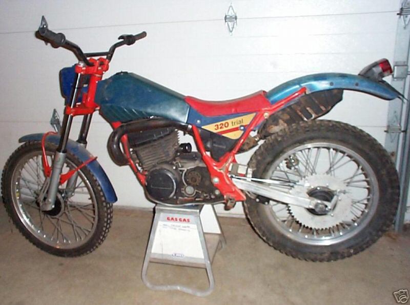

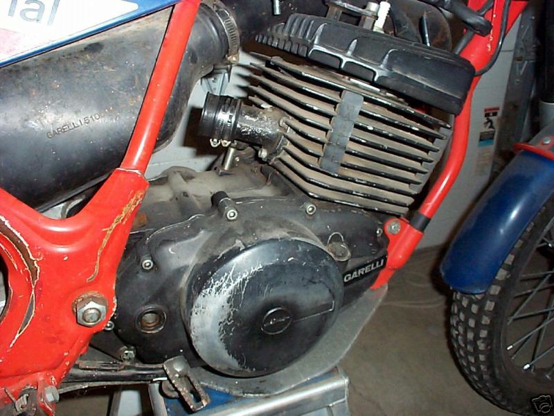

And lastly the other side of bike. Jay

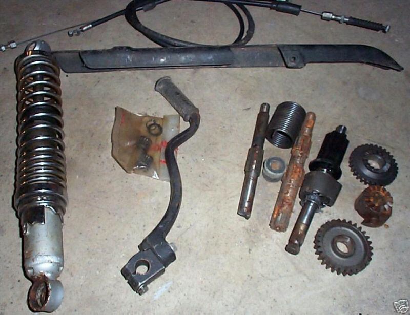

Thanks for the great responses! I will post pics of the broken kicker parts with this message. The bike has been languishing in the back of Jim Snell's garage since '88 or something. Donato broke it at Watkins Glenn NY ('85) world round and it was abandoned/orphaned in America along with a mate to it. Both bikes broke the kicker internals during the week before the WR so they didn't even get paint dabs on hubs etc. from tech inspection. :( Donato was very bummed and allegedly went home to Italy and quit, but a quick check of the records show he rode Garelli to 9th place in WR championships in '87 which is when I saw him ride the single shock disc brake Garelli which was very similar to this. (wonder what became of that bike?) This bike includes the spare parts shown in this picture, so my first plan is to try and get it going with what's included. Jim Snell said he isn't sure whether or not there's enough stuff to fix it. He says he has never tried to get it going in all the years he's owned it. I sure intend to asap. As for the Washougal trial I have been instructed by my Doctor not to ride it as I have just had another severe episode of "acute Sinusitis" which lasted for two days and long suffering nights, and I may be forced to have surgery in a few weeks (maybe) My terrible headaches continue to get worse and I am fed up with re-organizing my life around the headaches. I'll be thinking of you guys. Have some fun for me. Jay Lael

If it's only the kickstart shaft broken then it looks as if you will be able to do something with the parts you have. If not you could try and find another kickstart shaft with the same spline, counterbore the original and and turn replacement to suit, press the two together and weld - simple!!
I am doing this at the moment with my Cub and C15 to use cheap folding kickstarts bought off ebay for a couple of pounds instead of paying
Good tip Steve and I will post as soon as there's news. I am very excited to try and get 'er going. :( Jay
Thinking on from what I posted above - I expect they would be trying to squeeze as much power as possible from the engine for use in WTC. You may find if you lower the compression ratio and retard the ignition slightly not only will the bike be more ridable the kickstart shaft will get an easier time.
