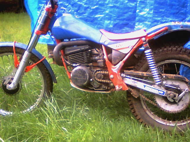

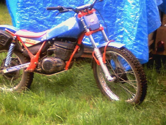

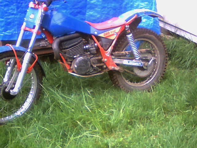

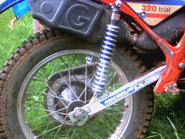

Not the hottest news item today with the culmination of the Scottish, but I just finished riding about ten miles of hard trails on the Garelli and she is really working good! I tried to take a pic but the batteries in my camera are dead. I will pick some up later and try to photograph it. The Falcon shocks from B&J Racing are perfectly wonderful, and though it took quite a bit of fettling I have the kickstarter situation well sorted. The Del-orto carb is jetted perfectly and it started second kick after 25 years! The bike is much heavier than my'04 Montesa but it has loads of power and has a six speed tranny! The first four gears are very close together. First gear is granny gear and the shifts to second and third all provide small gearing jumps. To put this in perspective, third gear feels about like first gear on my '04 Cota 315r, and fourth is just a bit taller than that, with bigger jumps to fifth and sixth feels like overdrive! This is a very well thought out tranny. Sixth gear feels like it'd go way too fast like 70 mph! The brakes work great too. The bike has quite a bit of compression and is a full 350 cc's, so kickstsarting it can be a bit dodgy. I think what may have caused the broken gear was a moment of distraction. Donato must have kicked it impoperly which resulted in a backfire so fierce the kickstarter gears had no chance to survive. I found it was critical to feel for tdc rather than just stabbing away blindly at the kickstarter. It popped back once pretty hard when I forgot to give it the "BSA treatment". Also I have been securing the rh footpeg in the up position when cold starting it just to avoid the remotest possibility that the kickstarter would catch on the footpeg which could also cause a broken kicker catstrophe as we know from certain older years of Betas. I look forward to many happy miles of twinshock trials riding on this wonderful machine. Sincerely, Jay
Edited by JayLael
Great pics of your bike Jay! Glad to hear you got her running finally. Now all you need to do is get your butt up here next year and ride it in our Outlaw/Twinshock series! It will be great to have you and the Garelli as some more competition for my mighty Fantic! :huh:
Cheers, Steve
It's quite fascinating really. I am told it is full 350 cc, but there are no stampings I can find to state this and I have not measured it so this could be a pseudo fact. It alledgedly has a magnesium cyl and head with a chrome bore cyl. Whatever it has, there is a noticeable piston slap? sound at slow tickover which disappears completely once it gets fully hot. It just runs so sweetly. I tried to top it out yesterday and ran out of room but I guess actual top speed is really about 50 mph. Steve, I will look forward to being your trials punching bag next twinshock trials. I have my birth certificate now so I can visit your country. I look forward to it very much. Jay :huh:

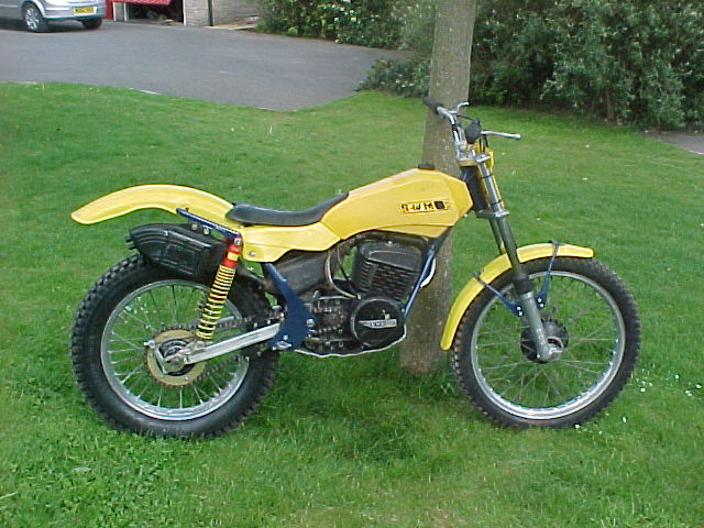

Jay....surprised you could get 50mph with that huge back sprocket.....looks way too low geared.
You can tell it was designed by one of the SWM guys, the middle and tail pipes, swingarm even the mudguard stays are copys....take a look at my 84 TL320.
Martin
PS.Nice looking fuel tank!!!!
Wednesday night I had a chance to visit with Kary and Dennis. They had some hilarious stories from the Scottish. They each had a go on the Garelli. Seemed to like it fine. Kary had been struggling up a greasy hillclimb for a three on his M4rt and then cleaned it first try on the Garelli. He took to it instantly as he had been an SWM guy in the "olden days". Also I managed a blistering clean through the "upper dry creek section: on the Garelli. It really goes nice. Thats two tanks of gas through it so far only the rear fender bolts have shaken out, but that's it. Pretty cool. Saving up for a rear sprocket. :rolleyes:
