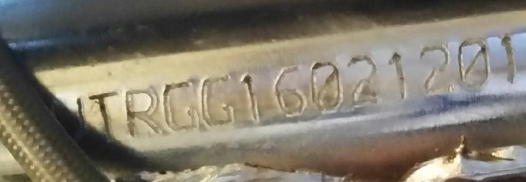

  13. I've been looking at a bike for sale that has no title or MSO, and his current owner got it from a friend who got it who knows where...
    The owner thinks it's a 2001 200 TXT.  Which is what the VIN would support:
    VTRGG 1602 1201 ****
    According to this thread and this VIN decoder this does identify it as a European / Spanish / Gas Gas / 160cc / from 2001.
    Now... when looking at the picture, it's clearly a TXT Pro frame and engine:
    So I am trying to figure out what's going on? And what model it could be and what model year this really is.
    The frame and engine are clearly TXT Pro (2002 and later) which would rule out the 2001 model year.
    According to the Gas Gas web site "Previous models"section there was no 200cc was available in 02, and 03.
    Which would make this bike an 04 or later.
    Looks like the 05 and later had a different lower triple clamp (solid with no slot as in the previous models) and a far bar which would rule out the 2005 and later.
    Body plastic: besides the yellow color... looks like some pieces covering the muffler) and possible on the opposite side too.
    Now... the pipe looks like a 2001 pipe...
    Any help / suggestions / idea welcome.
    Cheers.
