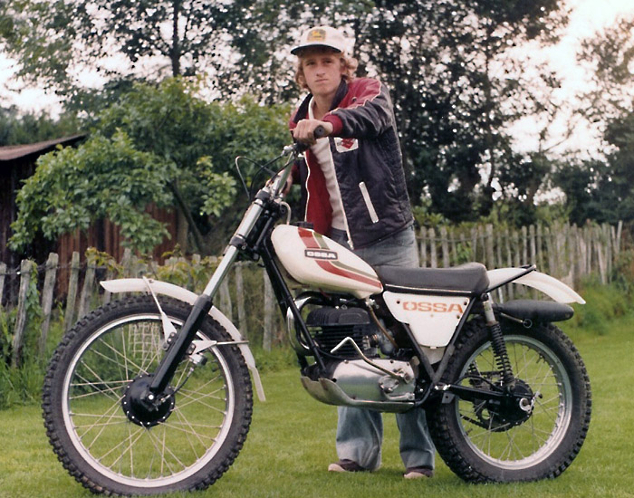

September 16, 200818 yr ... me and one of my Ossa's... some years ago Nice bike. Is it the angle of the photo or was the steering head really that angle? Looks like a chopper!!
September 16, 200818 yr Nice bike. Is it the angle of the photo or was the steering head really that angle? Looks like a chopper!! <sigh> Darn kids don't appreciate the old bikes...
September 17, 200818 yr It's either got the longer MK3 onwards forks or it is the angle of the photo that makes it look like that. The MK1 and MK2 Ossas are quite quick steering bikes
