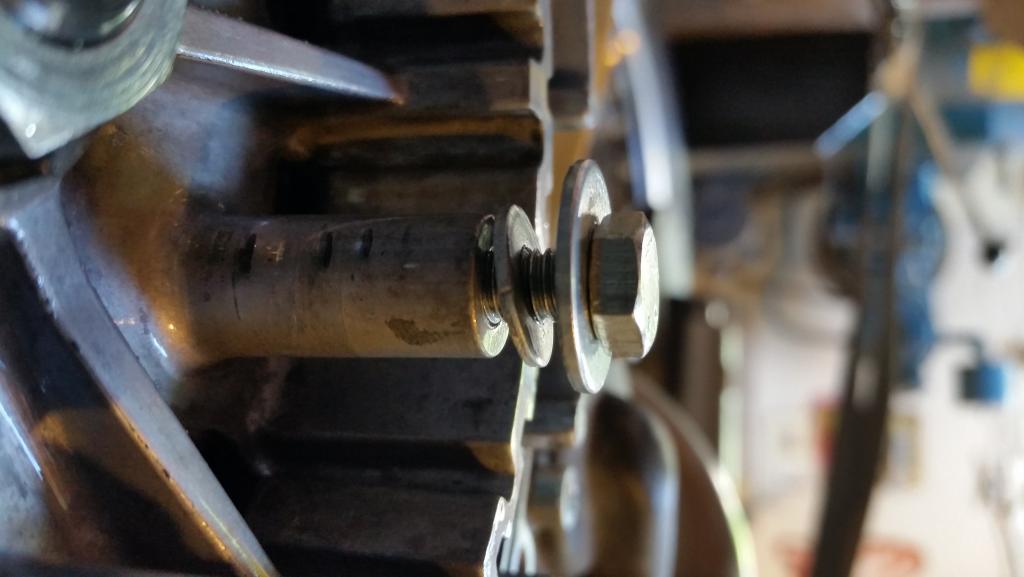

I am cleaning up my 2011 250 EVO clutch plates tomorrow, and would love to pick up the correct size shims today. Anybody have anymore input on this? Shim thickness, OD, and ID sizes?
I assume the shim/washer goes on the post side? The pic of the machined piece above makes me think maybe I am wrong in putting it on the post side of the spring.

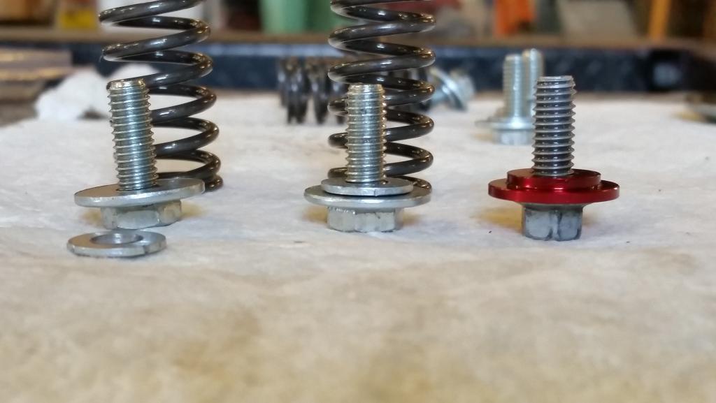

I just did Dan's clutch fix on my 2011 2t 250 Evo, and added a small washer between the stock washer and the post. This reduces the spring preload, and makes a lighter clutch. I have NO slipping, even in high gear. I may add another washer and see what that does.
The washer measures approx 10-11mm OD, and is snug on bolt, which I believe is a 6mm ID. I don't know thickness, but would guess about 1mm.
This picture shows stock set-up on left with new washer in front of it, new setup in the middle, and the right is the washer off my dad's 2011 Evo 4t 300. We think his was a factory team bike.
CLUTCH FEELS FANTASTIC! Mostly because it's not dragging anymore, and is consistent.
