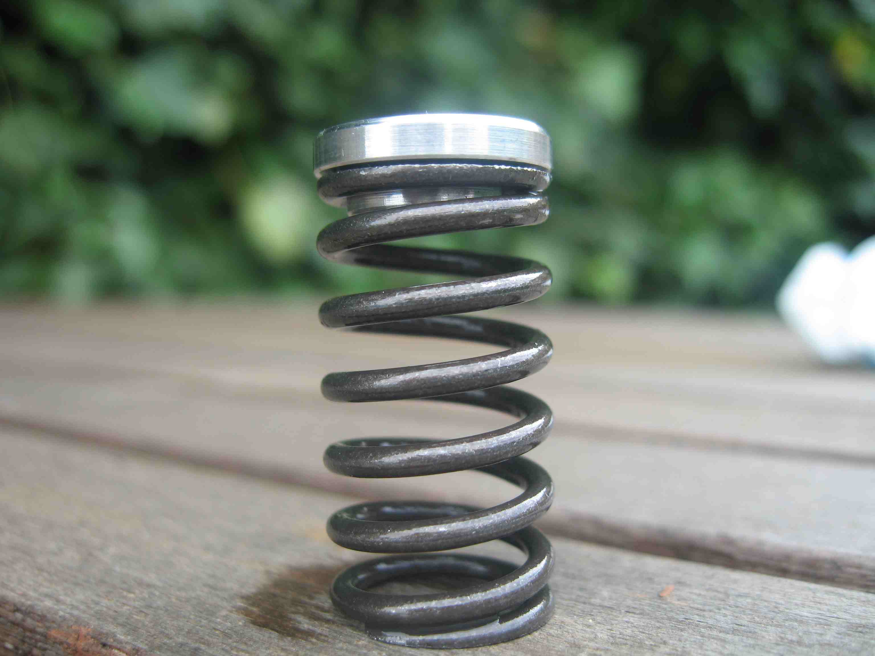

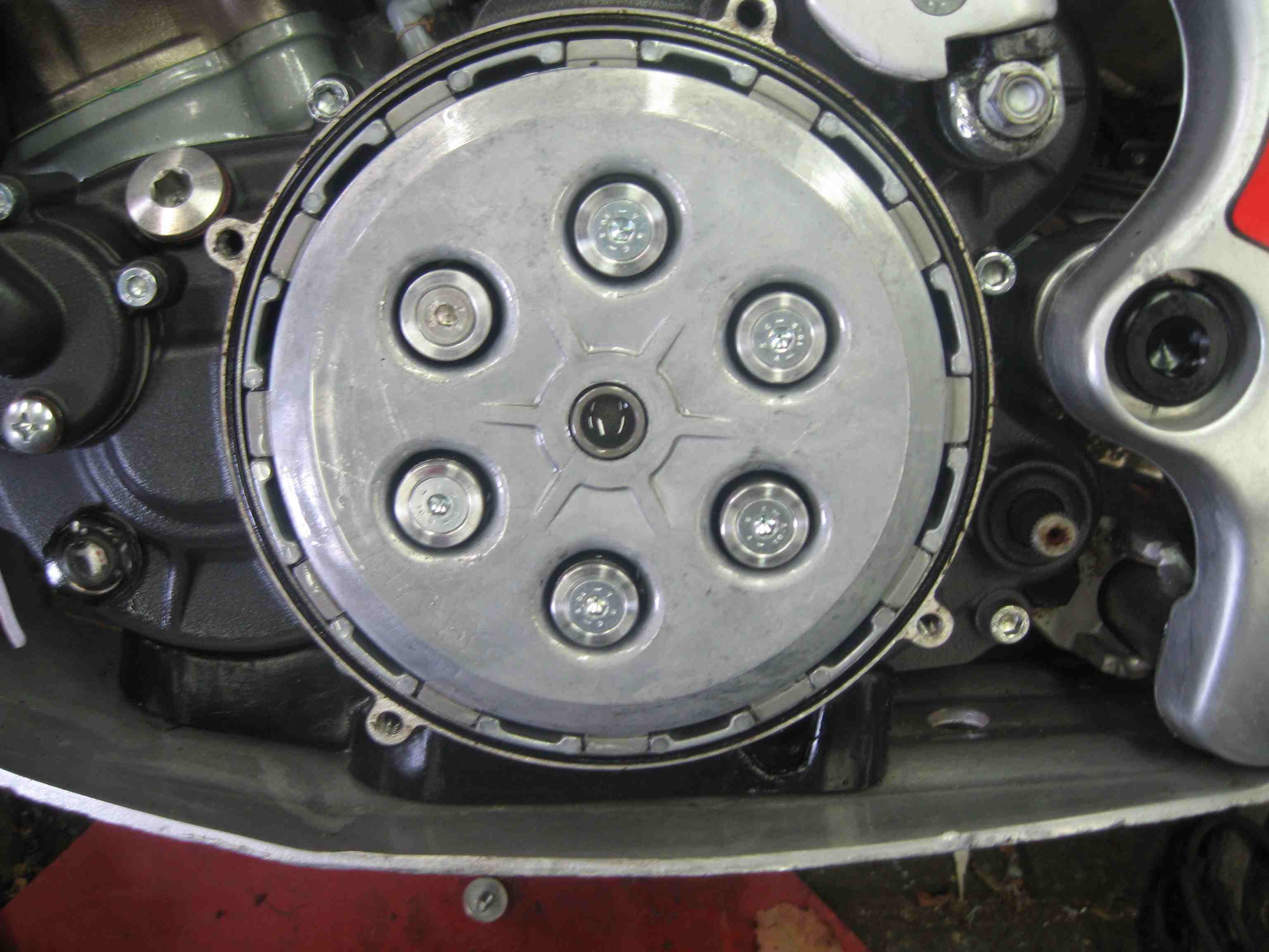

Having read the above, I have made some new spring caps that act as 3mm (0.120 inch) shims on the springs. I now have a lighter cluch that even looks better!!! (only when in bits though!!).
Is there a market for these? so i can make my fortune!! :D
IKB - Those spring caps look good. But....... what do the standard one look like? Surely by making them 3mm thicker you have inreased pre tension on the springs making the clutch heavier?
Talking of spring pressure, by adding shims you are not actually making the spring any weaker, just shortening it.
The best way to achive what you want would be to fit lighter springs. If these aren't available, how about grinding a litttle from the side of the springs? Make the spring thinner you make it weaker.
The standard spring cap is just a flat washer so the top of the spring is level with the top of the posts in the clutch centre basket, my caps are stepped so the springs are compressed 3mm less so they have less pre load making the clutch lighter. I think this makes sense at this late hour!!! :D
Simpley the springs arent squashed as mutch!!!
