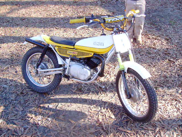

Just ran across a photo of a 80's Fantic 80 !!! And in my leaning this part against that part mock-up , is just about the stance I'll get when done ... (I hope !)

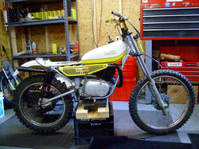

This transformation will be even easier than I thought ! I'm just gonna weld the xr headstock into the ty chassis and lengthen the stock ty swingarm a inch or so and all will work just fine , when I put some trials tires on the wheels and maybe some longer/stronger shocks than the ty80 Betor units . the triple clamp in the photo's has no brgs in it, so the fork angle is far from correct at this point ! And I have to make a anchor for the back brake and rebuild the forks ,but I can't wait to make it all work ! The back wheel actually clears the swing arm with a 3.50 knobby on it , although there is no room for chain adjustment , Yet ...
Glenn :D
Edited by axulsuv
How will you jack up the back suspension.?
Longer / stronger shocks and the swing arm will be a inch or so longer behind the shock mounts , and when bottomed out right now all that hits is the OE. fender which is going away anyways ... now to make/find a fender bracket to fit these skinny forks !!! And the forks sag about a inch and a half with just the weight of the bike on them ... IT'LL WORK !!! (I THINK ) And besides the back wheel,spacers and all slid right into place and the sprockets line up ! this was meant to happen !

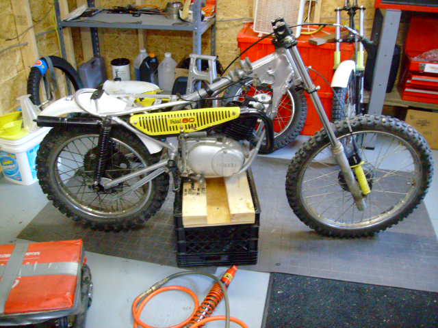

A prior to welding mockup/fit... The fork angle is about 26.5deg. at this point witch will work ok , as the rear will get a 17'' rim (when I find one to lace to the xr or ty hub !) and I've located some CHEAP 12 3/4 '' rear trials shocks that should suite my needs ok for now . And I have to put the swingarm extension directly inline with the factory piece so my sprockets still line up . the way it is pictured the rear one moved in about a 1/4 inch . But those changes should make every thing work well ! And I found out that a later model yz80 used a 428 chain , so I can upgrade the chain size too ! Yes I'm really bored , its either do this with one hand or sit in front of the TV all day while my shoulder heals ... and I can wrap my good arm around the ty and lift it onto my workbench with one hand , so at that light weight , it may be a ball to ride !!

One other detail , got to add abit of metal to the steering stops ! cause right now they just miss the stops ,forktubes hit the tank and it's turning almost 85deg.!!!!
