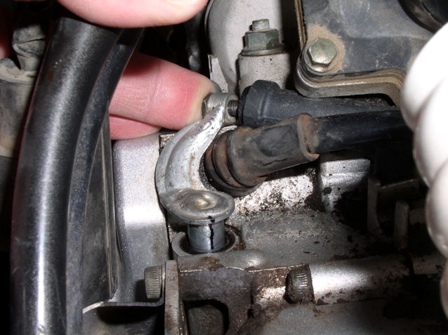

If I remember rightly some Sy's were prone to a partial failure of the weld on that(pictured) actuator arm where the shaft disappears into the crankcase?
Could this cause the symptoms you describe?..maybe a Scorpa pro' could chime in here.
YES - But normally slowly loose adjustment as weld breaks.
G520 I suggest you have a close look.
