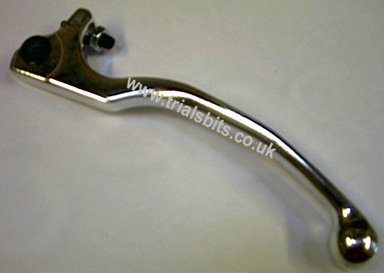

Will this clutch lever on www.trialsbits.co.uk fit my Gas Gas TXT 125?
AJP is it compatible with Gas Gas?
Urgent Help Needed, because of upcoming trial.
Any help, Greatly Appreciated.
:D YD Richard Longstaff GD :D
Look closely at the cover of your master cylinders, and even on your old levers.
They will say AJP.
That should be the right lever.
Although....I think that's a long lever.
You might want a "shorty".
They stay farther from the end of the bars and are less prone to breakage.
those are the apico ajp relica levers i got em but the shorty version there are two down sides to them though.
1.they are like glass they snap easy so keep your master cylinders a bit lose so it can move when you fall
2. they come in this crapy goldy finish that looks out of place but for the money there good
Hmmmm They look like the right leavers but I dont think the acu allow youth riders to use short leavers but im not completely sure about this ill have to look in the acu handbook.
