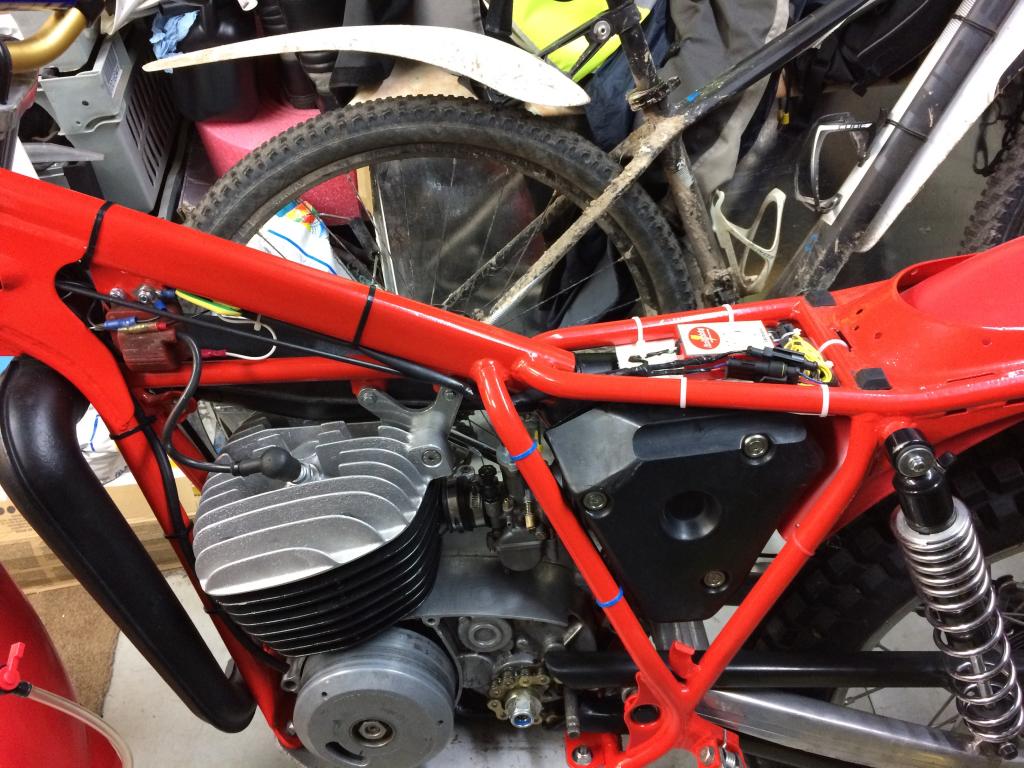

Build update, installed electronic ignition from RMlightning, absolutely brilliant bit of kit very easy to install and setup, fantastic help from Julian, will update with full description and pics to follow.

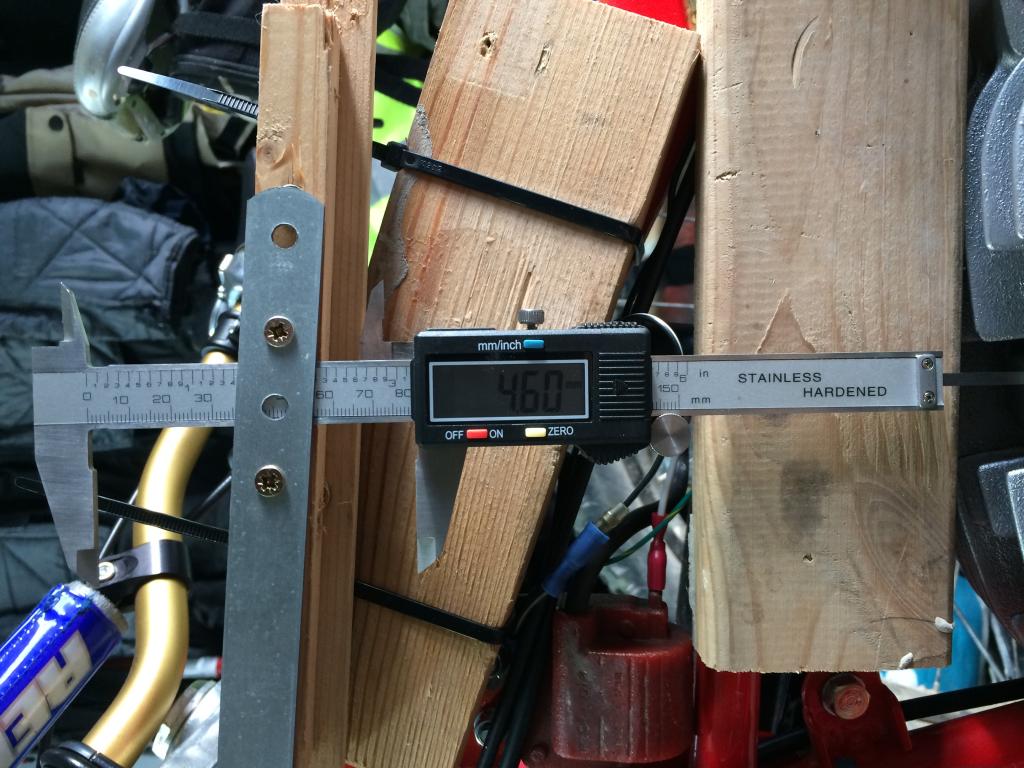

Had to get 4.6mm BTDC for the 242 so thought this might do the trick

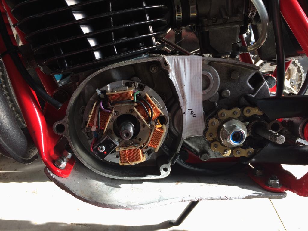

This is the Hall Sensor pickup that replaces the points and condenser, the encoder magnets are attached to the inside of the flywheel,
CDI Location under seat, just enough room.
