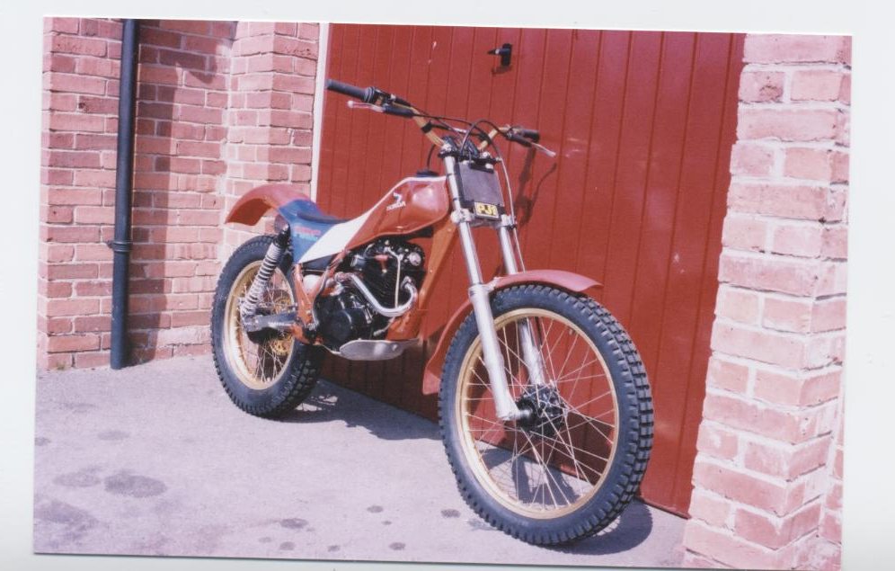

I purchased this TLR some3 years ago from John Lee M/C Acording to John It had been stored for 12 years prior to him buying it. The general condition then was ok, the engine ran well, but the whole bike really needed stripping and brought back to as near original condition as possible.Some markings on the engine and wheels pointed to it possibly being used in the SSDT at some stage and also the engine has RTL250E005169 on it? is this normal? I rebuilt the bike 2 years ago to the standard you can see, and i then went to register it for the road and to cut a long story short discoverd it had been registerd by Honda Uk in 1986 with the reg number C613 UBY. I would be interested if anyone might know what happend between 1986 and 2001.
Just to point out that it is very smooth no spitting or coughing that keeps getting mentioned on the forum. It has an external oil feed, as can be seen and a few people that have rode it always comment on how nice it is compared to other TLR,s.
Had a look at my two bikes this morning - both have similar engine numbers begining
ME07E-5******
I would advise against quoting full engine/frame/reg numbers on the web.
Could you post a couple pictures of your engine on the site - ie with the tank removed then someone like 'Big John' who dreams about RTL's and can quote some of the RTL part numbers off the top of his head may give a yeah or nay whether or not the bike has an RTL motor. I have seen other TLR's with external oil feeds - at the Manx classic trial last year if I remember correctly.

Externally the RTL engine is almost exactly the same as the TLR250
Whats the internal differences - apart from gearing?
