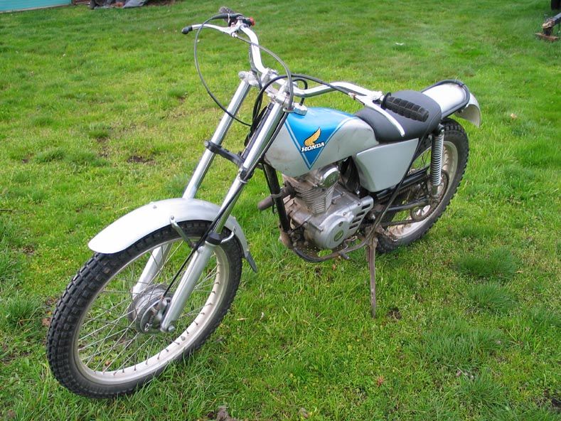

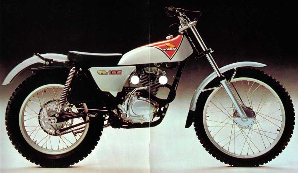

What about the TL range of bikes, see quite a few TL 125's on ebay, can be had for the
I'd be tempted with a 125, if only for the reason of cost!
The engine looks very much like CG 125 stuff which I would imagine there's loads of bit still around
I think they do look quite nice,Had my eye on one on ebay recently, the seller was local to me and I nearly put a bid on but his reserve was a bit steep. Here's another pic:
