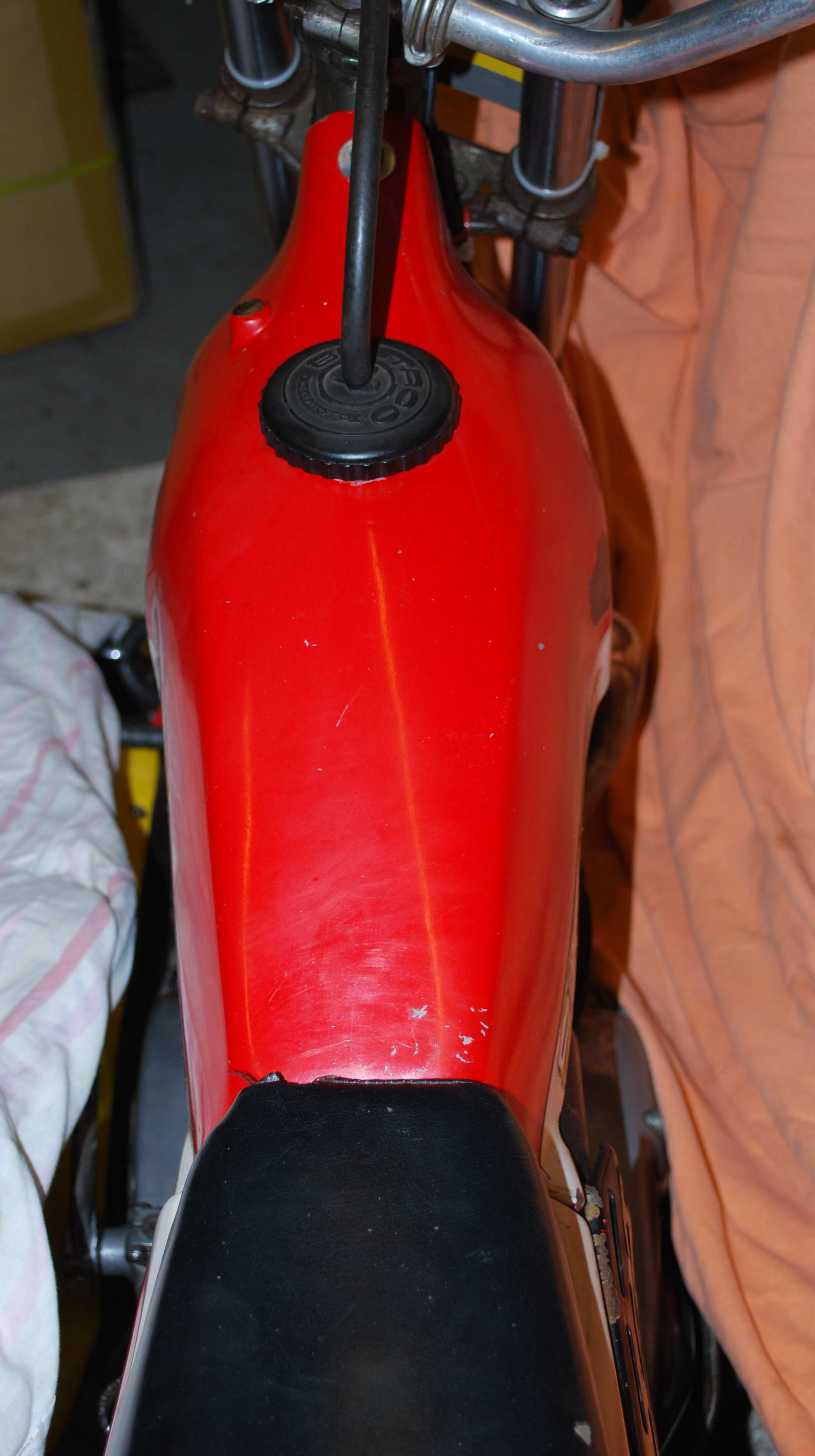

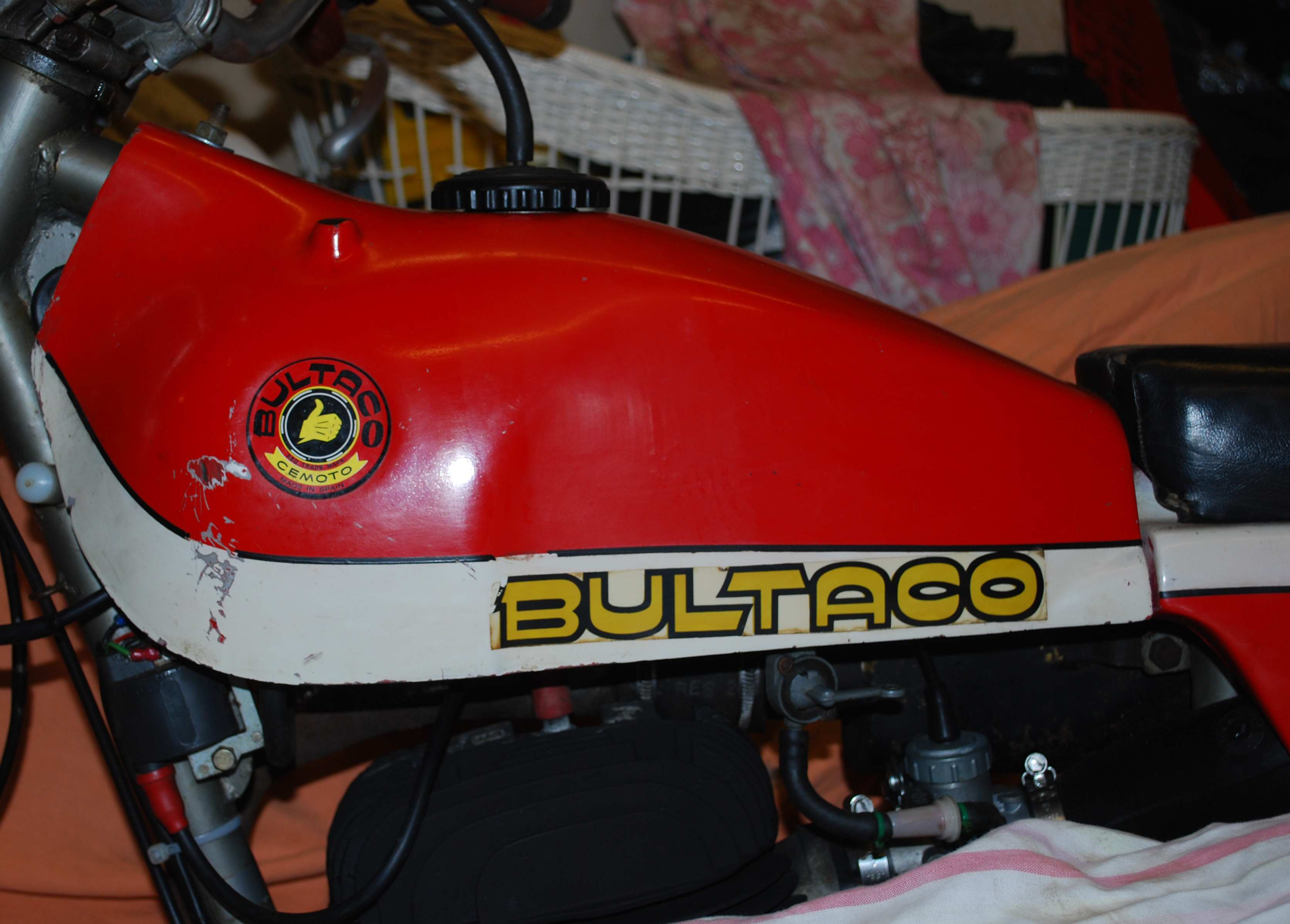

Anyone else notice that looks like a later tank, with the M49 seat. Interesting. More pictures without the rider in the way perhaps?
I have checked out the tank against the photos on cemoto.tripod.com.I think it is a model 49 tank with a later cap fitted,it dose have a breather outlet forwad and to the left of the filler cap and the indents for the nee.Also when grinding back to make the repair you can see in the photo I went through a cote of silver paint. I may be mistaken though.
I will take some photos later today from all angels to see what you think.

Here are a few photos of the petrol tank.I hope they help.
