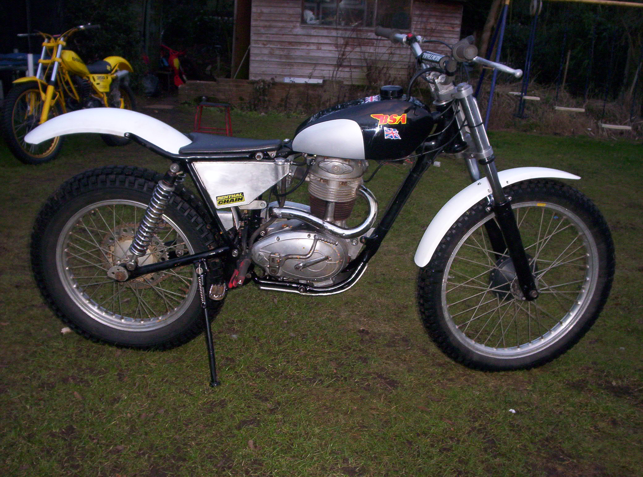

Totalshell I built a standard D7 Bantam only mod. was 21"front
rim and a wider rear,only did one trial on it and it was
terrible.Enter Evo 2-chopped frame/sub-frame,Honda XL100
tank,complete GS125 front end(£30 from ebay),electronic ign.,
homemade exhaust all built in a 8'x4' shed with not alot of
money just a wee bit imagination.Still to trial it but its
like night and day to ride and didn't break the bank British Twinshocks is the way ahead. Evo2001.jpg

Well I must have hit a nerve? I have what you would call a trick cub and in some peoples eyes is a 6 grand bike. The fact is I built most of it in a garage and small shed. I machined the barrel casting put PVL posts on the crank case ETC. The next bike that is built will have even more home machined parts on it. The bike I have gets a hard life as I am not a very good rider and do not mind admitting that. Anyway I also do machine work for quite a few of the major suppliers. And what makes me laugh is the nonsense that written in how to go about doing things by then talks.
