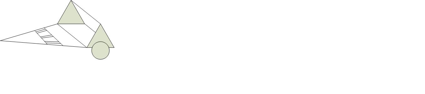

I made a three bike one a few years back and the only issue is I never got round to properly rust protecting it.
Its a just a simple pair of light (250KG I think)independant suspension units mounted on a flat triangular trailer with another upright triangular frame that the bash plates site on. A strap across the seat is all that's needed. It's super light and can be easily stood on end for storage. Simples.
Your better building it from angle as you can paint it properly, box will rust through from the inside.
yes bigfoot, im looking at similar designs... want to be able to get two outside bikes facing forward and one bike in centre facing backwards...... think the design on the left will allow handle bars to miss each other a bit better but design on the right would be a bit simpler to make ...
