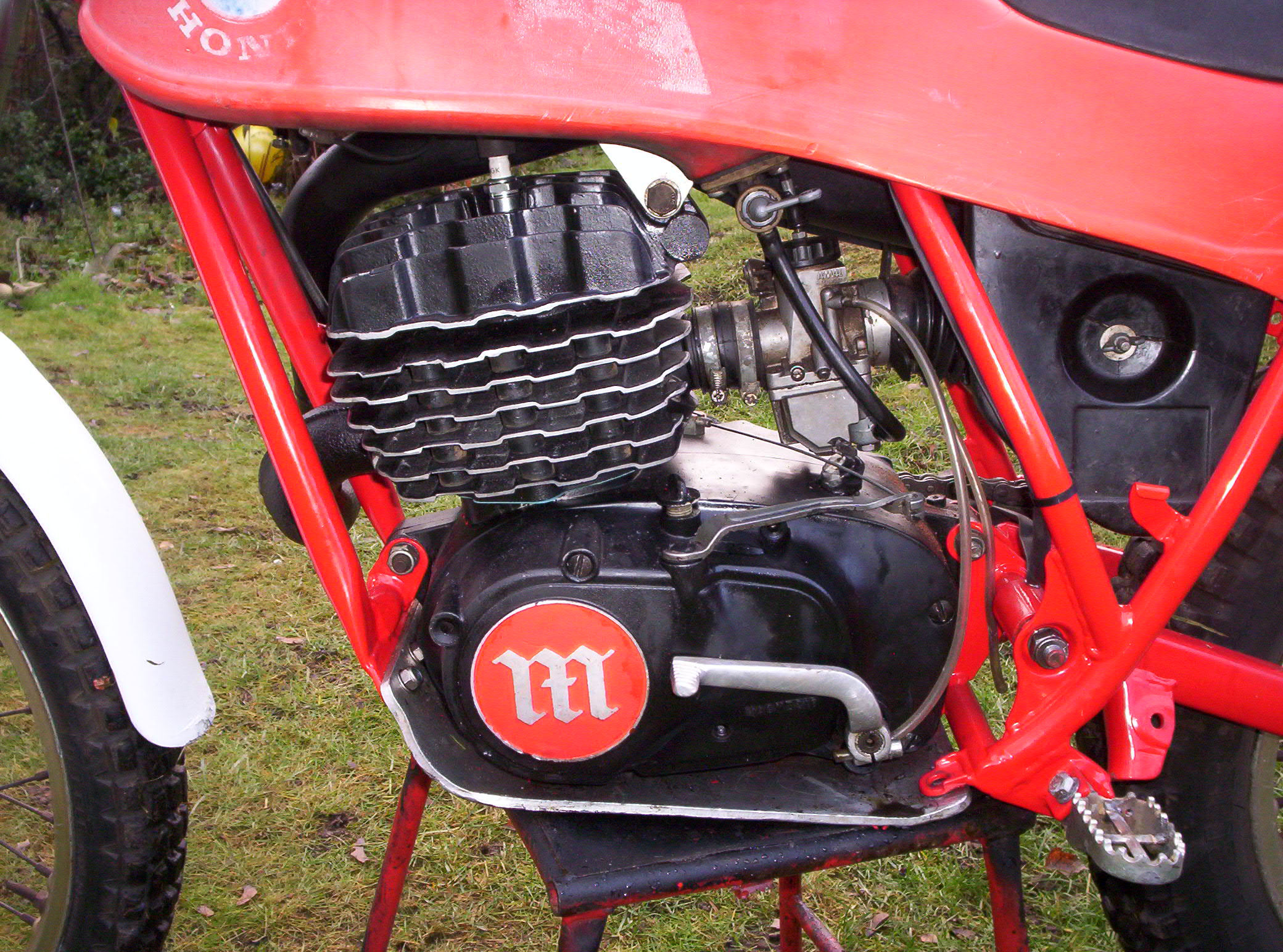

Woody, I'm just getting ready to lower the pegs on mine, and I can't make out from your pic how you did yours. Did you build a "box" off the lower section of the frame, or did you make a bracket, or what?
Very tidy bike, by the way! :)
Good timing - just logged on and there is your question...
I just welded a piece of 4 or 5mm thick plate to the back of the frame tube, shaped to take the new bracket. Then welded a strengthening gusset behind to stop it bending in or snapping off. The pegs were lowered rather than set back any significant amount, maybe just a few mm but that's all. The bike is already light on the front due to the torquey motor. And it grips plenty good enough without needing the pegs further back.

This picture should show the footrest arrangement better
