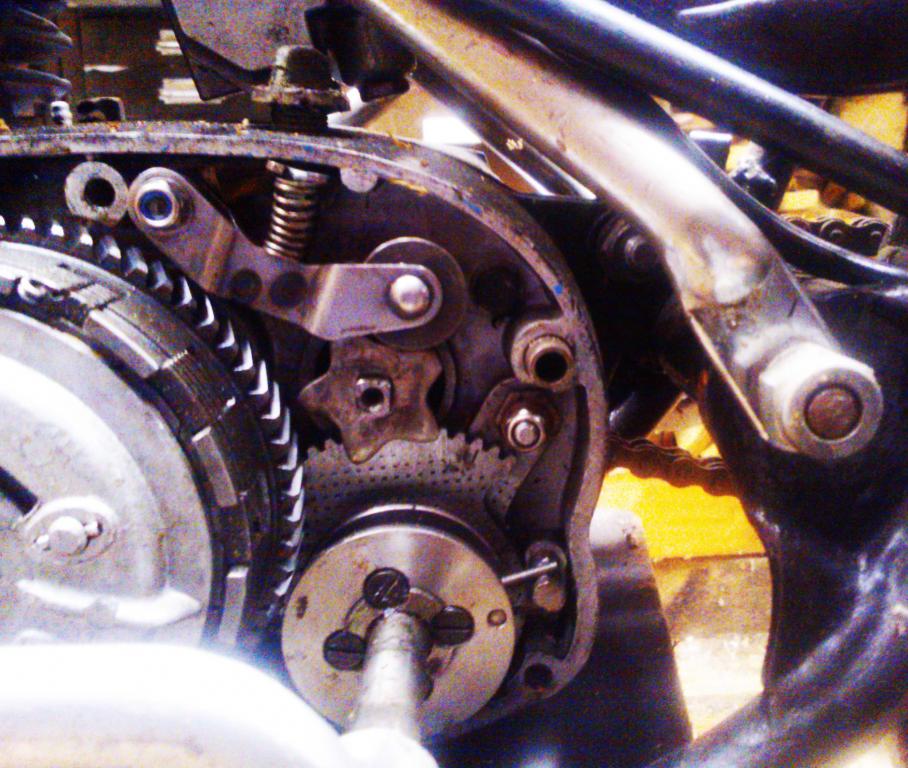

anyone know anything about the additional indexing device fitted to my 348 ? I have three 348 engines, there is the ratchet device that common on all of them and most other Montesas but this third engine has an additional index plate fitted to a square peg on the end of the selector drum. it uses a crude looking spring and roller arrangement.
Most of this engine has been thrown together so I am trying to find how to set this part up or if i should miss it out altogether.

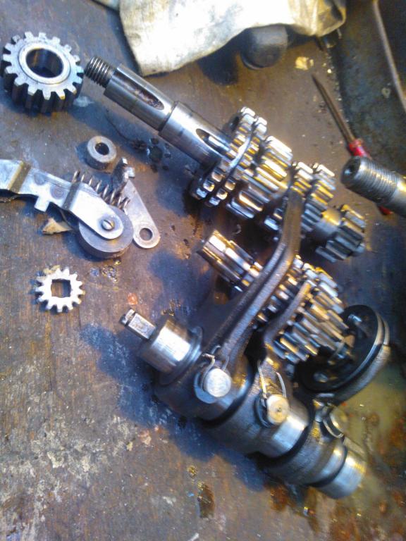

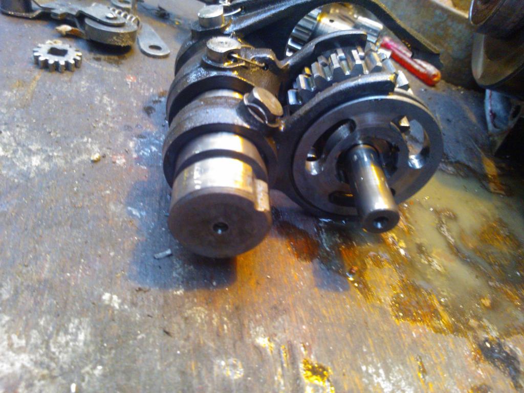

I have had a 348 engine lying around for a while and took it apart yesterday.
I found that there are two types of gear selector used on the 348 engine.
Both have a shaft that is indexed by the spring plunger you find under the big bolt at the back of the gearbox case.
one version only has one indent and uses the cam and wheel device.
The other has 6 detente slots and no detente wheel or cam plate.
this may be useful if you are buying second hand gears. None of my parts lists show the cam plate version.
I have not swapped everything round yet but they look interchangeable.

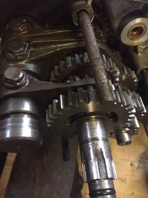

Hi - I have had the gear box stripped and it is working on the bench, but there is too much movement in the gear selector drum, so it is vibrating and then jumping into gear.  Does anyone have a picture or diagram showing the selector drum set up pls?
