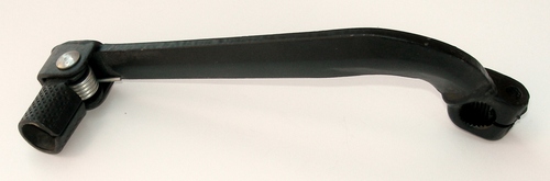

I'll get a shot of the shifter asap , Same one as I put on the 240 ...

I have the shifter,just came with no tip,was super cheap if I remember.

I have seen the knurled end about an inch long which was cut off handlebars for a kid, then pressed onto the nub of a shift lever with no tip.
Worked just fine for Ronnie Commo! Got any old bars?

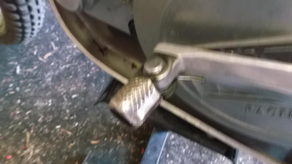

post-1232-0-02396600-1362846864_thumb.jpgYes it's a phbl 26 or 28 , can't see the size clearly with it on the bike ... And Doug here's a photo of the shifter on my 240 , the section one is the same ,only aluminum. I didn't go to NC for school due to a rough week @ work (old and real sore...!) So I'm gonna ride the section in the yard and get it good and hot and see what she wants/needs ... Besides what I've already ordered for it .

And again Doug , here is a photo of the actual tip of the shifter , It can be duplicated with a spring and a small piece of pipe with a notch cut out of it ... I'm sure you can devise something !!! post-1232-0-98719100-1362869528_thumb.jpgpost-1232-0-95714400-1362869599_thumb.jpg Sorry for the bad photo , but you can see how it's done ...
Glenn
