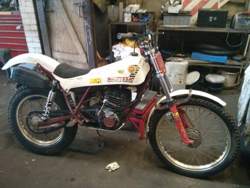

That's a great pic of a lovely bike.
I have tried to make a replica myself.
cbe09746-de7a-46b7-b498-bb0833c264bd_zps6a00cf4a.jpg[/url]
Will probably put the original silencer back on as it's not quiet running right yet.

It wont do with that WES on it. I tried one, and it went straight on ebay, choked the motor and it wouldn't rev!
Interestingly I had that exact problem, took it out today with both silencers, much better with the standard one, hmmmm, may take it apart and see what's inside.
Hi there,
The late model 349 and MH349 definitely run better with the heavy standard rear box. I have a virtually unused WES back box somewhere in the loft.
The standard rear box has a baffled first chamber and an absorption second chamber. The first chamber can be heavily blocked with carbon and oily gunge. With care the standard rear box can be cleaned and repacked without having to reweld it.
