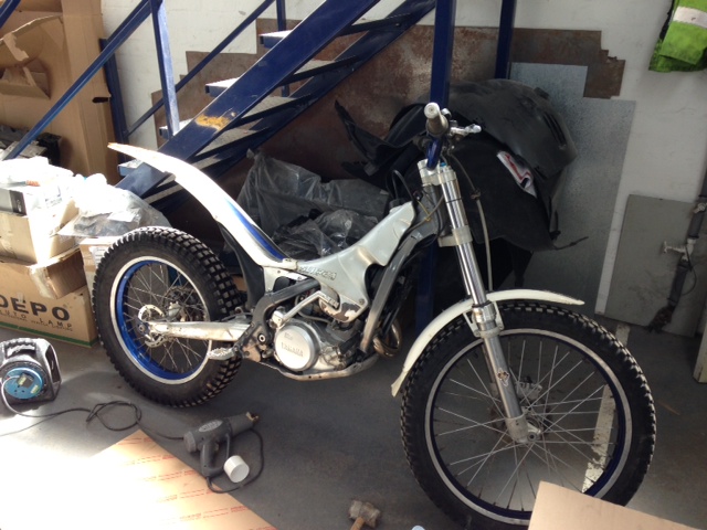

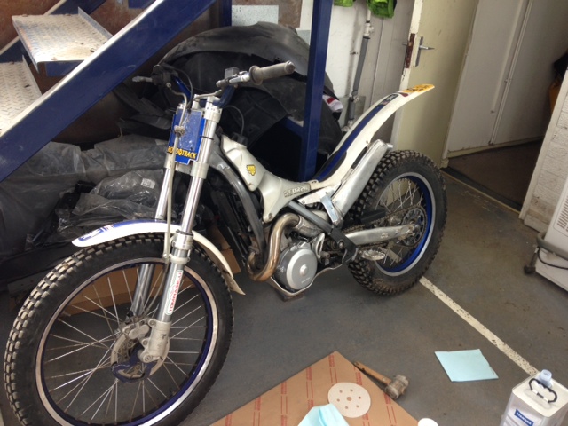

September 18, 201313 yr I though id upload some pics of my tatty 2001 SY before and through the re-furb . I purchased this bike cheap from ebay this summer after my last SY was stolen back in spring. It looked very tatty but sounded sweet and was all I could afford at the time. I have ridden in it in a few events through the summer and now while theres a break in the calendar I thought i'd pull it apart and get it looking a bit nicer and do a bit of routine maintenance at the same time. Parts changed: Wheel Bearings F+R Tyres F+R Fork Seals Air Filter Fitting Gas Gas Pro Side Stand Many rusty bolts for stainless I'm still in the process of changing the swing arm bearings, painting the clutch casing, engineering a FLAT bash plate, fitting up LED front scorpa light and renewing the decals to something a bit newer.
September 18, 201313 yr I don't think that's where the master link goes.... Make sure you grease those stainless bolts or they could take the aluminum with them next time they come out. Edited September 18, 201313 yr by charlie chitlins
September 19, 201313 yr Stainless is for show bikes,even if you grease them or use anti-sieze on them they stand a good chance of sticking and damaging the aluminum.
September 22, 201313 yr Author I appreciate your concerns with the stainless bolts guys, I use a marine grade grease and torque them up as suggested. I've changed for stainless if I've had them available and never had any issues in the past. Today has been spent replacing the swing arm bearings (I have the number if anybody wants it message me) and seals. Refitting the swing along with shocker and newly painted coil spring. Also finished off my LED headlight, doesn't look much different at the moment but will upload more when its lit. My decals aren't going to arrive for a few weeks so the plastics will have to wait as I want to use it next weekend and get some practice on it. Bearings requiring changing progess !
