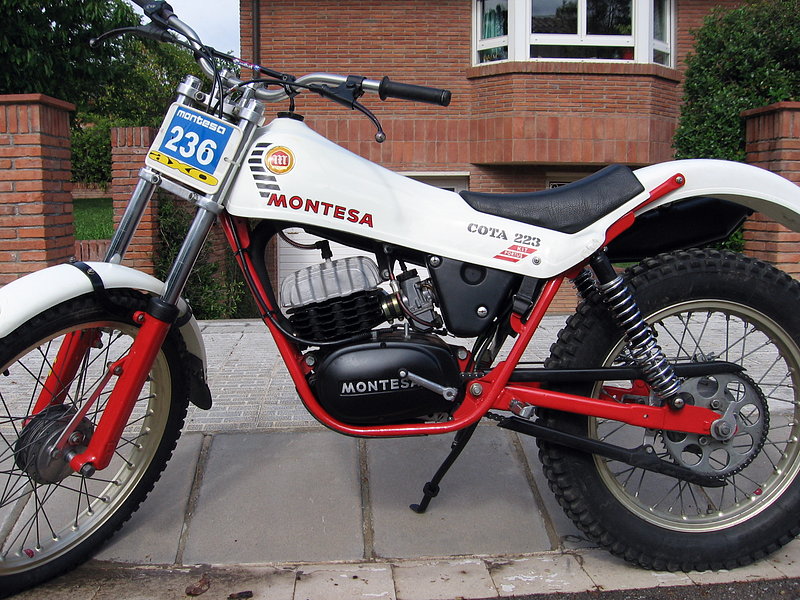

Montesa Cota 223
sorry cant get link to display but if you just google you will get the page up

you missed 311 and 314 from what i can see
Well that's a new one for me. The clutch cover looks like it's off a 307 or similar. Top end looks like a 200 but must be bored out. I imagine it was a kit. The 200 was a superb bike but, again,the gearbox is delicate. Apart from that it was very good with Nigel Birkett riding it with embarrassing success over Sandifords then #1 rider Malc Rathmell. Birks was told to cease and desist and give his team mate a chance. Biks didn't and was fired.

There are my current levels: a level 200 with 223cc kit and Portús of 330. 223 These were some cucumbers, clutch modificábamos them, we put a carburetor larger, wide triple clamps, swingarm length and a motorcycle was super fun.
sorry this came off a spanish website and googles translation not great
Portús of 330. 223
So there we have it. A Portus kit for the Cota 200. I seem to remember that Portus passed away quite recently.
Ok, if you say so <_<
don't know where the cucumber thing came from google translate version of something?
anyway if you do the maths a cota 200 barrel bored to accept a standard 247 piston 72.5mm would give you 222.9 cc this could be good fun as my cota 200 is getting a bit of piston slap watch this space
It appears that the 247 and 200 share the same gudgeon pin height and diameter
