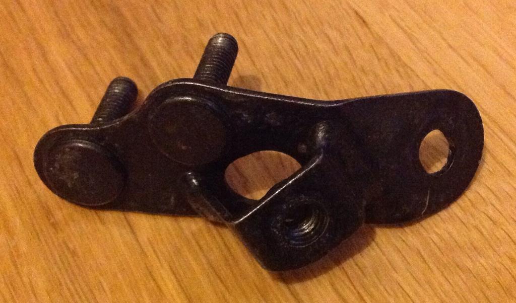

Anyway, to answer the OP questions, the standard is the quietest, looks good, but is about twice the weight of the Mitani system. Termignoni is the most expensive and I'd say probably the loudest, but looks the best, but if you bin it, you could wreck it, whereas the others have covers. Neither the Mitani or Termi have been designed to inter grate with the new rear mudguard, the mitani would require either the carbon cover moding or the mudguard/air box shield cutting down, you'd also need the old pre 09 silencer/mudguard mount bracket. The Termi also requires this bracket. (Touch the pic for full image)
