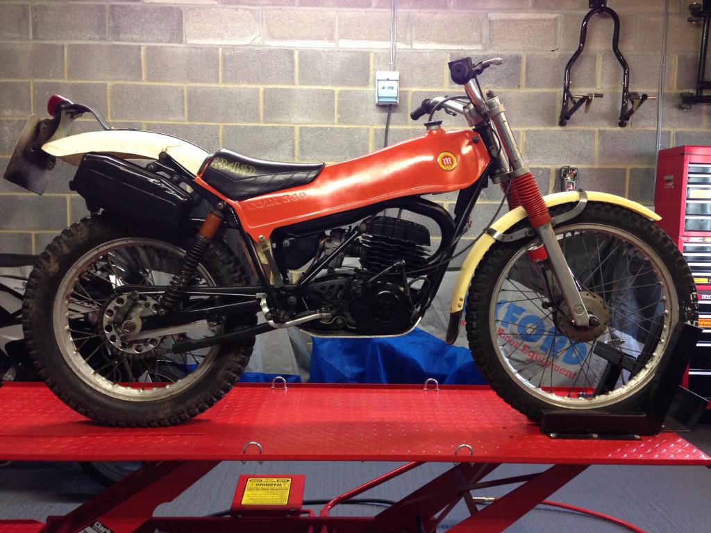

Hi, I have just got my first twin shock trials bike and intend to do a full restoration on it.....I fact I have already stripped it down ready to get the frame painted.
No doubt I will have many questions as I start to put it back together, but I just have one quick one at the moment. Could somebody tell me what colour the upper engine support bars are supposed to be. Are they polished or painted silver? Apologies if that is not the correct name for them, but they are the bars that go across the engine at approx 45 degrees. At the moment mine are black but I know that is incorrect.

Nice bike. Looks like it was just touched up with paint. The lower chain guard was trimmed up too. Still very nice shape for the year.

Looks very sorted, if you ask me about my personal opinion I would leave the optical apperance of the bike as it is, the patina looks quite good.
I would firstly sort out any technical issues that might be there, then all get these parts back in original shape you need or want to have and then probably do a paint job, if there is any need ...

Hi there,
Looking at the picture the bike looks very original. It appears to have the Akront fat bars and twistgrip which came with the bikes when they were new. The rear suspension units are also the same as fitted to my own 349 which was bought new in 1980. From memory they are Telesco Hydrabags. I cannot recall if my own bike came with a rear chain tensioner when new. I know there was one when I parted with the bike. The tensioner mounting boss is fitted to the end of one of the crankcase screws in place of the nut.
From the picture I would suggest lowering the stanchions through the fork yokes until there is about 6 mm of the stanchion above the yoke. This should keep the steering quick enough without the front mudguard contacting the exhaust on full fork compression.
The rear brake torque arm looks too long, standard should be about 220 mm between the centres of the holes. A new rear brake cable may be needed. Changing the torque arm should improve the action of the brake.
If the kickstart lever is mounted too far forward the stop lug on the kickstart shaft can punch a hole through the flywheel housing.
When the foot pedal is folded aim for it to be parallel to the cylinder fins or just pointing downwards.
Gearing is good with a 10T gearbox sprocket and 40T on the rear wheel.
Set the ignition timing at 3,0 mm BTDC for a good starting point, if the power is too fierce try retarding the ignition.
The joint between the main exhaust and rear box is sealed with two "O" rings fitted in grooves in the rear box pipe.
Hope the above helps.

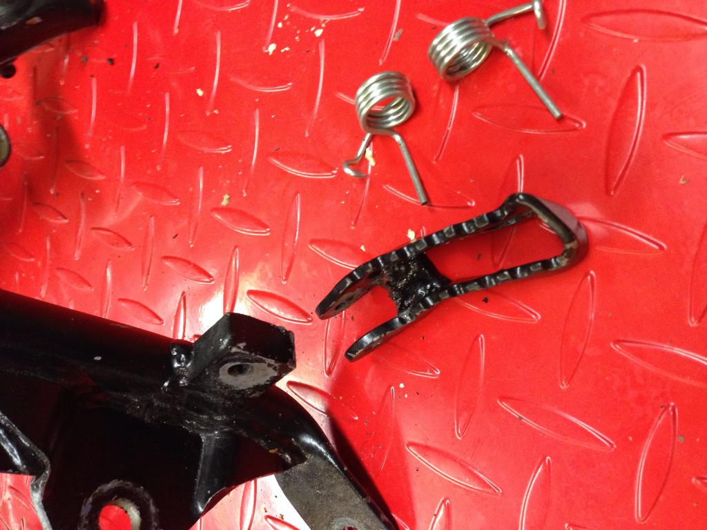

In the picture below it shows the blocks fitted to my bike for the foot pegs. Do you think these are the original blocks? If they are I can't figure how the springs are supposed to go. The springs were loose in a box when I bought the bike.

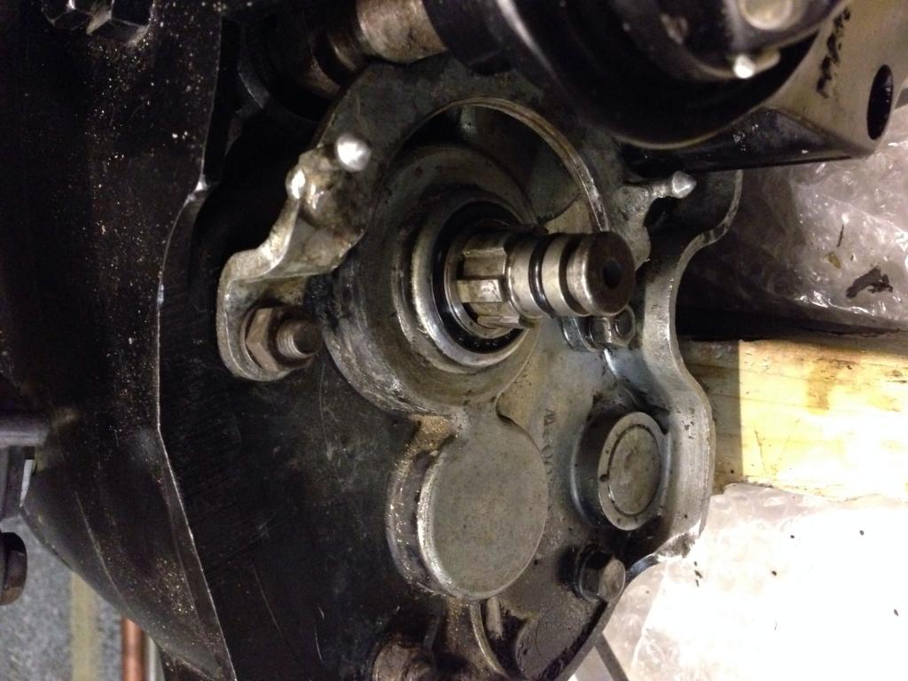

In the second picture, the main drive (output) shaft where the front sprocket goes on is leaking oil. Is this a big job? And is the seal accessible from the inside?

those look like kick start return springs
i have the same model 349,it too leaked from the same place ;it had been modified by fitting a metal sleeve round the shaft' and a larger internal diameter oïl seal to fit the sleeve this appears to lubricate the chain ....in reality it only lubed the floor....i took the sleeve out and the carefully hooked out the seal(no need to split cases) i then carefully pressed in the new seal using a large seal and the old seal flat face to face....looks like your missing the chain tensioner on mine it is mounted on the lower bolt holding the chain guard it should be the longer of the two bolts don't know if you can swop just the one bolt and not split cases you will have to remove the clutch cover ;to get at the bolt head

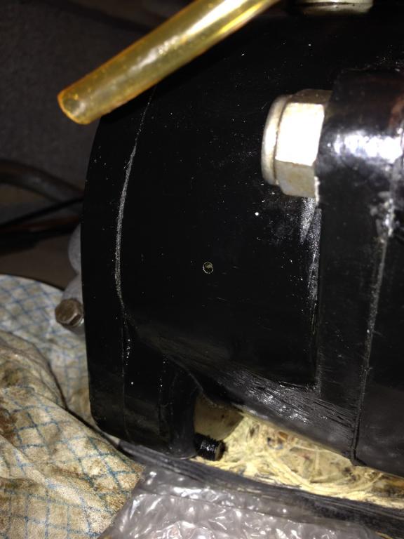

Today I noticed a small hole in the back of the engine. It is 2.5mm in diameter with no thread. Should it be there? Does anyone know what it is?

Nobody know anything about the hole shown in the picture above?
Should it be plugged or something?
