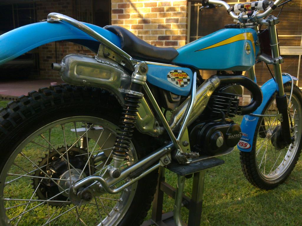

The Miller replacement for the clubfoot, I have one and its very light. I am worried about using it because the outlet area is a lot smaller than standard (so there will be more backpressure).
Does anyone have any experience with these? Any good??

I can get it to fit, but Im more concerned with performance (or more to the point, putting a hole in my piston..).

You'll probably find it just strangles the motor and makes it run roughly - which bike are you trying to use it on?
You'll also find it's probably noisier than a clubfoot as well, as there isn't the volume. I have a newly repacked original banana on my '72 325 and I altered its inlet and the outlet of the middle box to the same as the later bikes and, on the banana exit, cut off the end of the 'spout' which is tapered so that it wasn't restricted. It's now about 25mm instead of around 20mm (or less) Makes a decent pop pop noise at low speed but even though it's all repacked, it still isn't as quiet as a repacked clubfoot.
