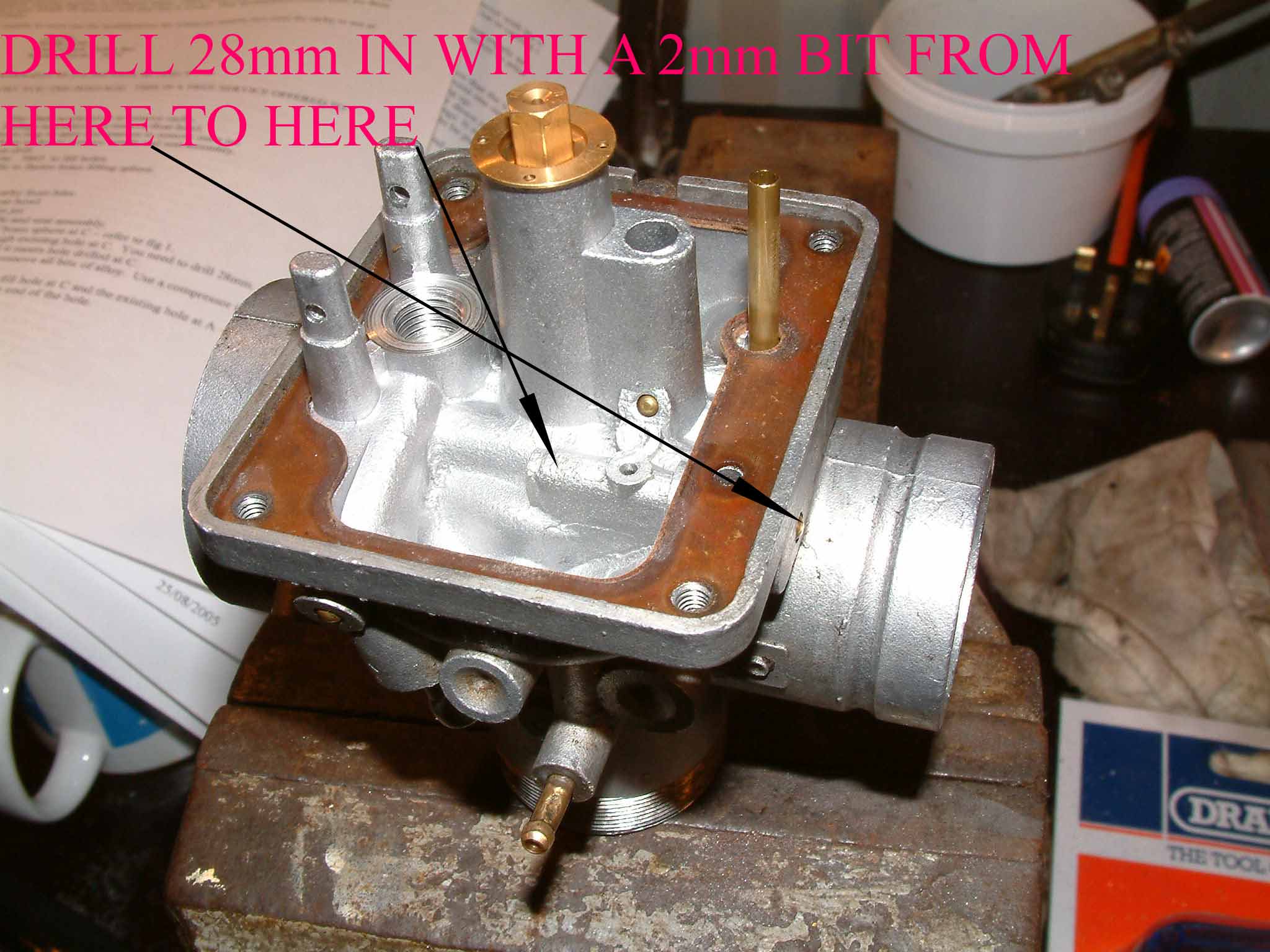

Hope you enjoy your drilling Mark...how about posting some pics of what you do???? :D
Will do Stu, off for some Beer tonight :wall: so best not make a start when I get in :blink:

Twating thing won't let me download second pic :blink:
I'll try some more!

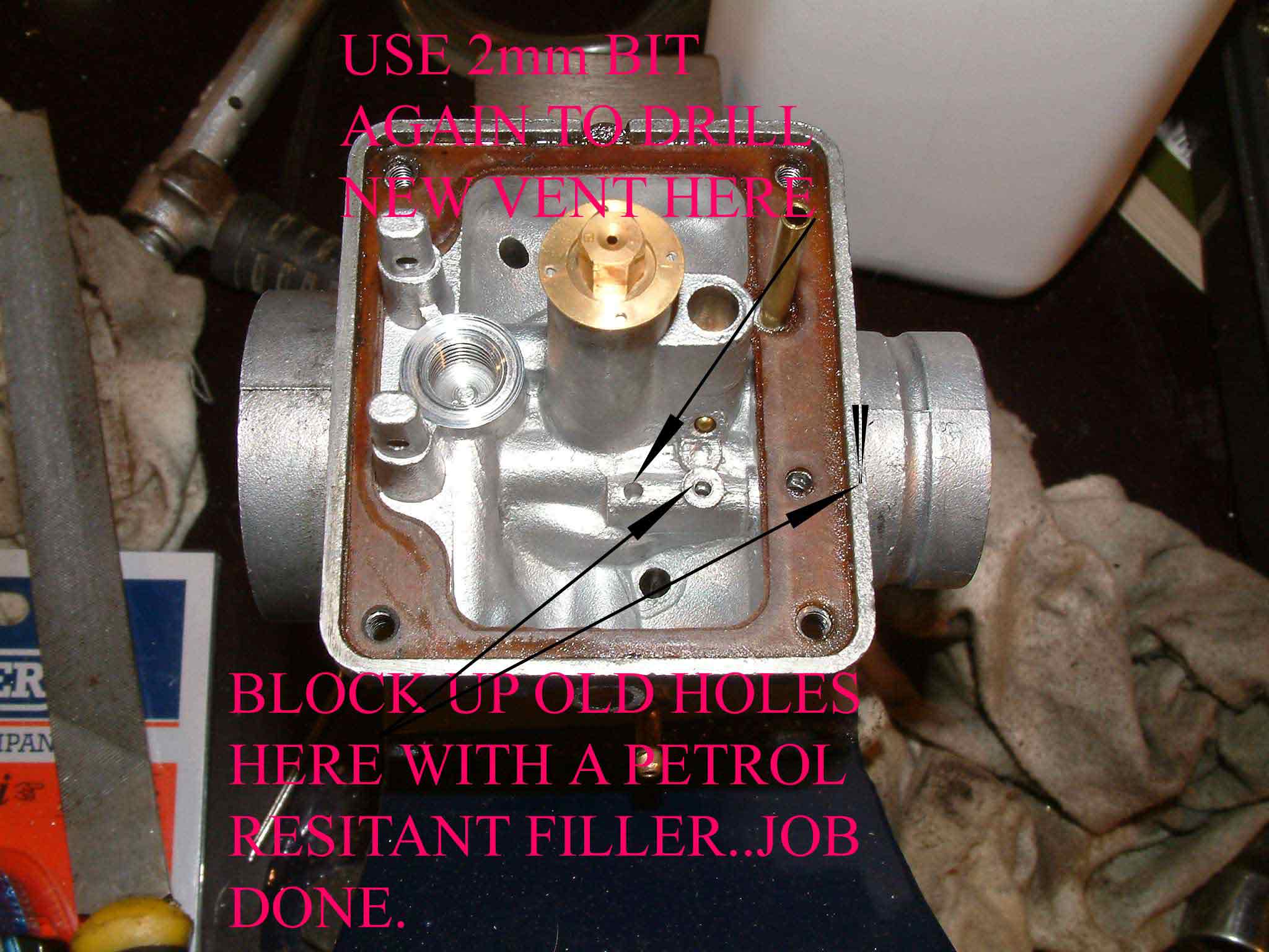

Try again ! CARB DRILL MOD PIC 2
Pretty easy really :blink:
just got to try in out this weekend now

Thanks for your excellent pics ..please let us know how it performs afterwards..I'd like to try it myself, and might well do that, just that I think I'm not steady enough with the drill...we'll see,,or maybe I'll still splash out on the Dellorto?? :blink:

Go for it Stu, you have only got to drill the little brass ball that blocks the hole and do that small drilling at the end of the shaft.
All it's doing is extending the height of which the fuel starts to overflow...it's the same mod that BVM etc will charge you
mmm..certainly would be good to check out the 06...will let you know if/when I get brave enough to get the drill out! :blink:
:blink: Hey Lads - The old Outlaw has been doing this mod for his customers for quite a few years now FREE !!
I got all the info from John Lampkin so maybe check with him - the later model bikes come with the new spot to drill already casted but not drilled -(Strange)
However this does make it a bit easier to drill in the correct place
This corresponds with what I found on my '04 carb. The part about drilling through the brass ball is not necessary. You can tell if you have the new type because the spot is obvious.

Most strange indeed, like they know there is a problem but do a half hearted job to try and fix it :blink:
I would have thought that Lampkin would have pushed the factory to sort it out in the early days...never mind in 2005 !
Don't forget to measure how far you need to drill and wrap a piece of tape around the drill bit to stop it from going too far.
