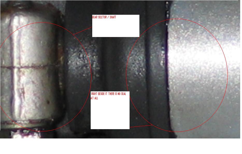

Gearbox Problems

Took the engine out the night and the seal seems to have blown right out of the bit I
